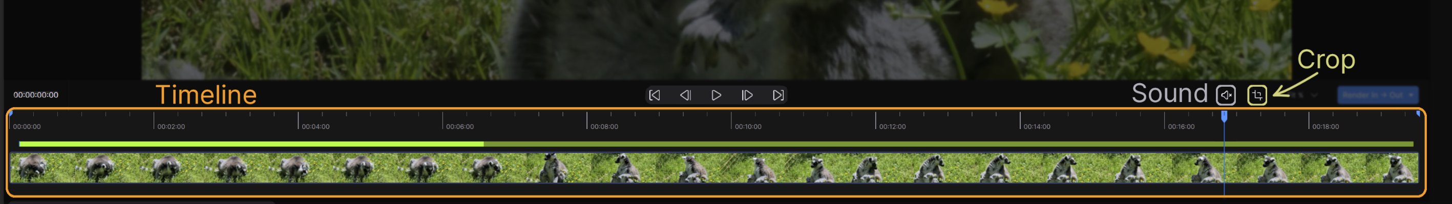

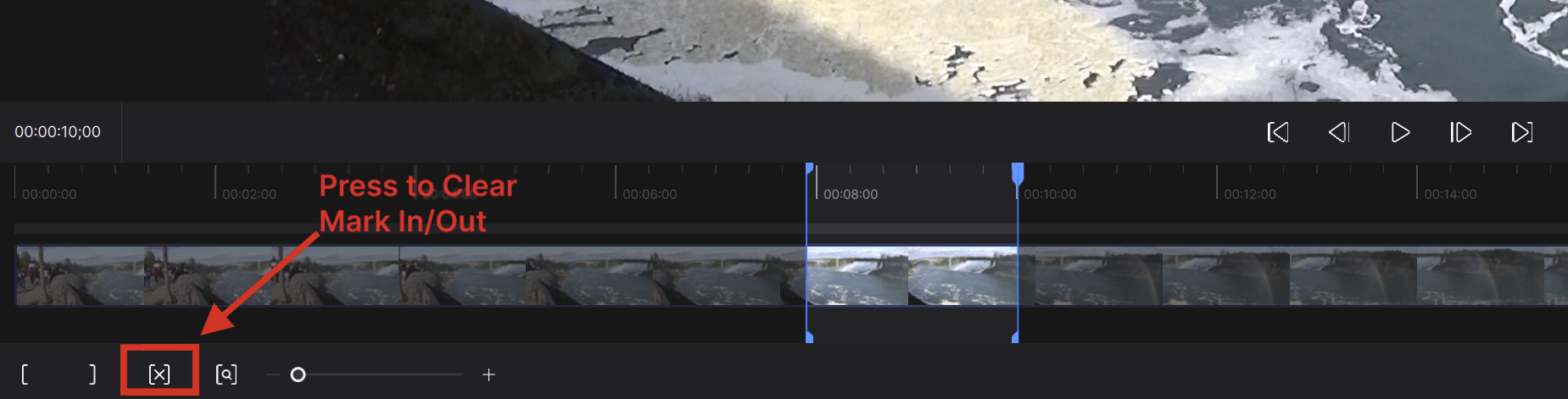

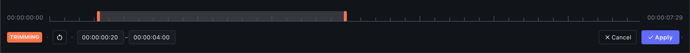

Trim
To trim, use the [ ] buttons on the left side of the app's timeline.
  • The in-point in the sequence where the clip begins and the out-point in the sequence where the clip ends.

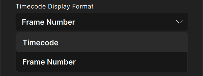

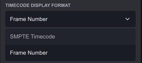

Using Frame Number vs. Timecode
To set the trim by frame number, select frame number instead of timecode in the preferences menu.
  • Allows for more precise control over the range of the selected video.
  • This setting will also change the length of Previews in Video AI to be displayed in frames instead of seconds.

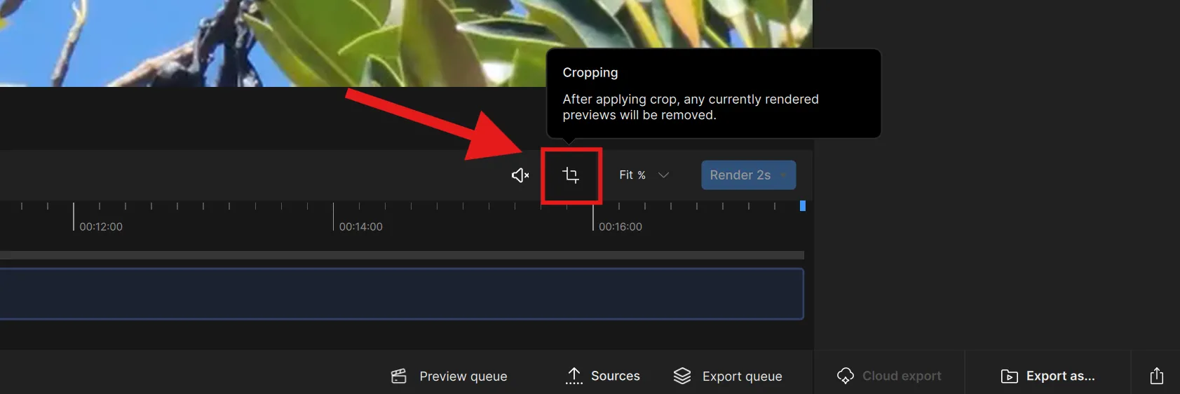

To crop, locate the crop button on the upper right-hand side of the Timeline.

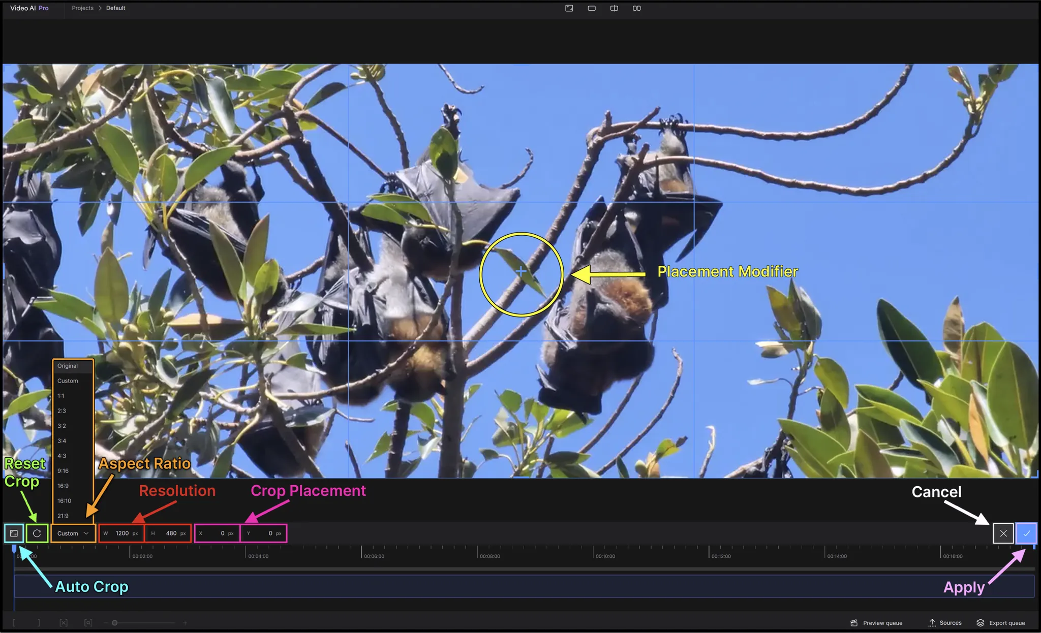

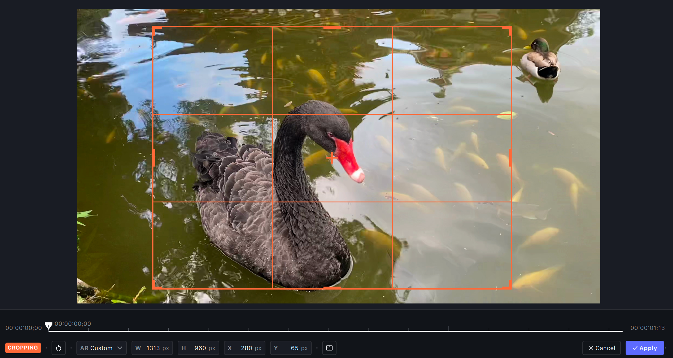

The crop menu has the following features.
  • Auto Crop: Automatically detects top/bottom bars along the perimeter of the footage and sets the crop dimensions to fill the screen.
  • Reset Crop: Any changes made in the Crop Menu can be reverted to the original settings.

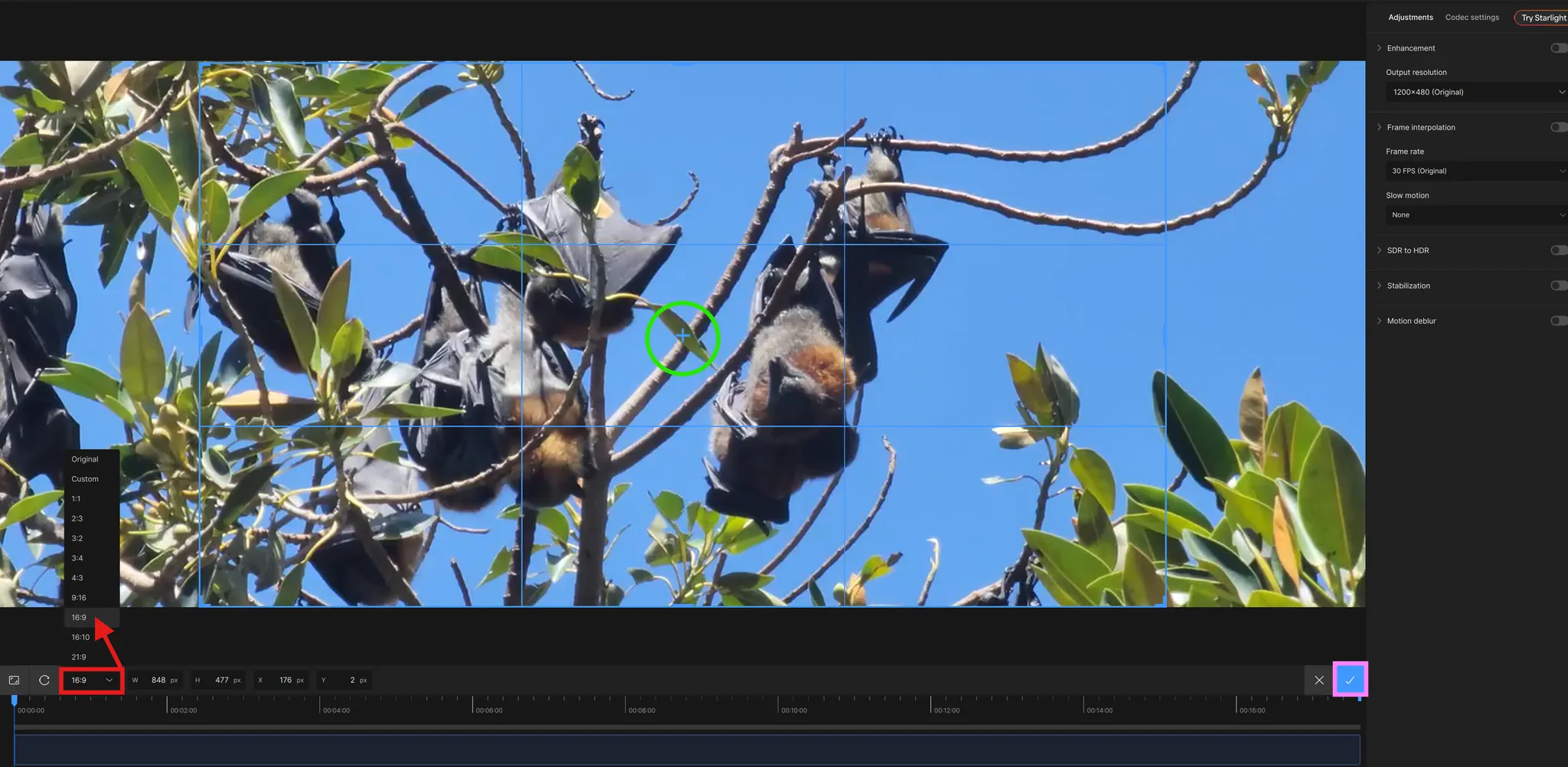

  • Aspect Ratio: This is the ratio result based on a video’s width and height. This determines the shape of the video. Note that this will not scale up, any change will be cropped into the original dimensions.
  • Resolution: This requires the width and height dimensions to determine the size and aspect ratio of the video. Note that this will not scale up, any change will be cropped into the original dimensions.

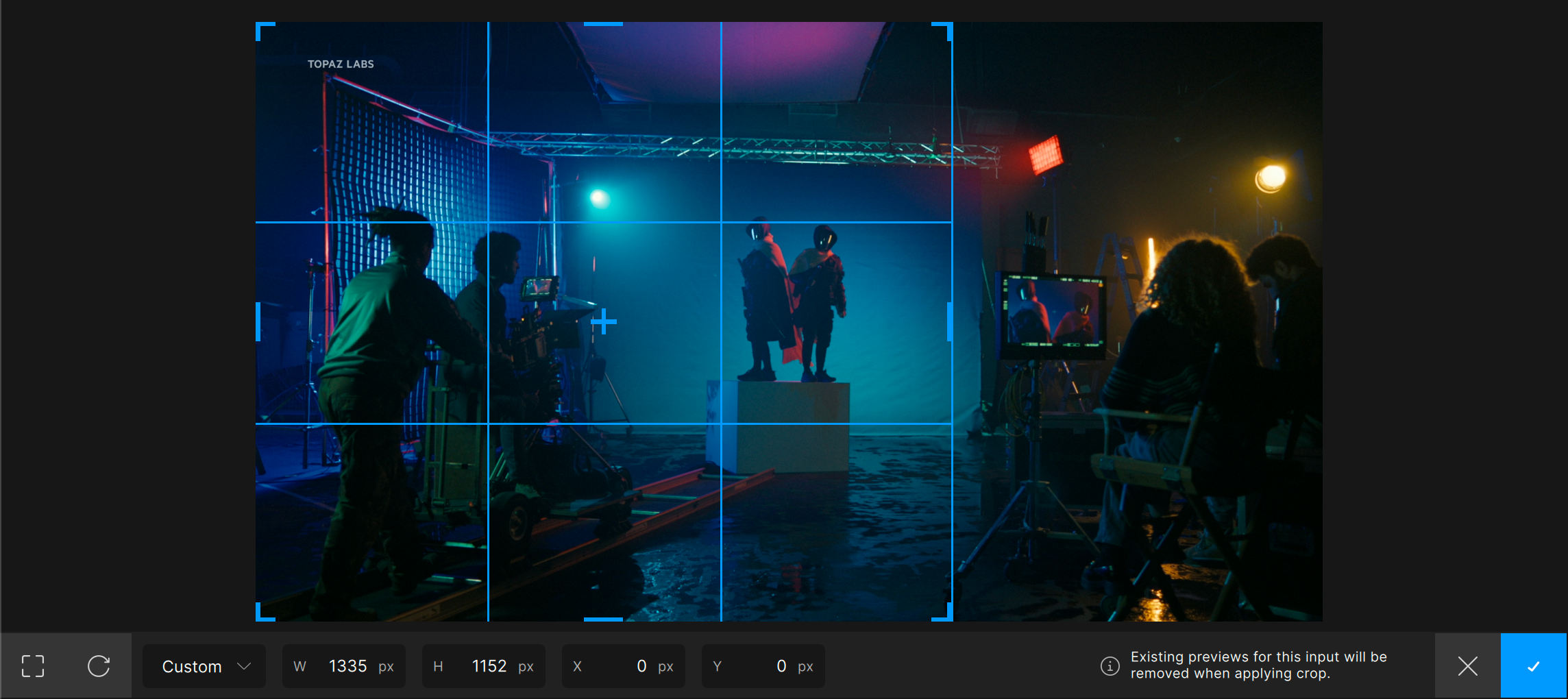

  • Crop Placement: The blue grid, is the crop extraction. If you chose a resolution or aspect ratio smaller than the original source, you are able to change the placement of the crop. At default this would be a centered extraction, with the “X” and “Y” values set to “0”.
  • Placement Modifier: If you chose a resolution or aspect ratio smaller than the original source, you are able to change the placement of the crop. You can use the blue cross hair “+” to move the crop grid manually.
  • Cancel: This allows you to fully cancel in modifications made in the Crop Menu
  • Apply: This actually applies any and all Crop adjustments to your Video. Please note that the newly established dimensions will be considered original resolution within the application.
Keep in Mind:
  • To save, press the Check Mark button.
  • To cancel, press the X button.
  • To reset, press the circular Reset button next to the Auto Crop button cropping label.
  • Any previously cached previews on the original input resolution will be removed since there is now a new input resolution.

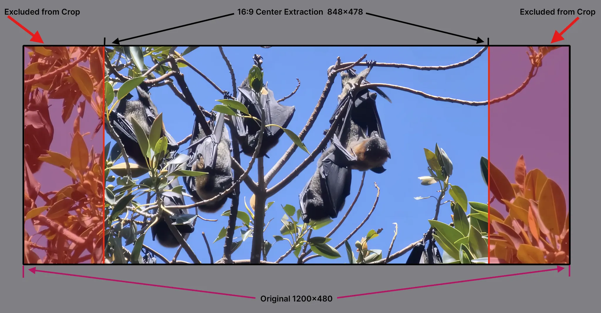

For this example, there will be a center extraction based on an aspect ratio of 16:9 from a file that originates as 1200x480.
  • The original source was a custom 1200x480
  • On the far left, change the aspect ratio to 16:9. This will change the resolution to 848x477.
  • Here the user is able to move the crop by utilizing the center blue "cross hair" to the preferred spot. At default the crop will be a center extraction.
  • The "check mark" is clicked to save.

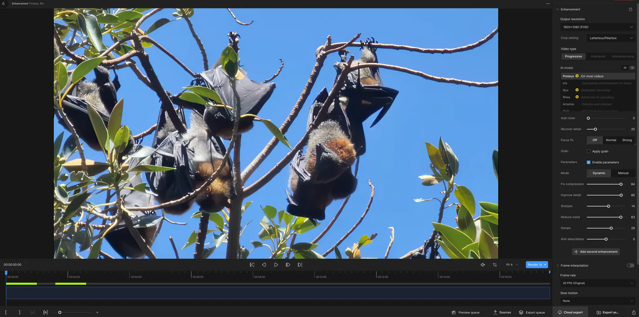

  • Once saved, the new resolution is 848x478 and considered as "original" within the application.
  • As a new “original” resolution, Enhancements and scale ups can be done. Here, the Output Resolution is set to 1920x1080 (FHD).
Below shows the result of the new resolution upscaled and enhanced with Proteus using some custom Dynamic Settings.
