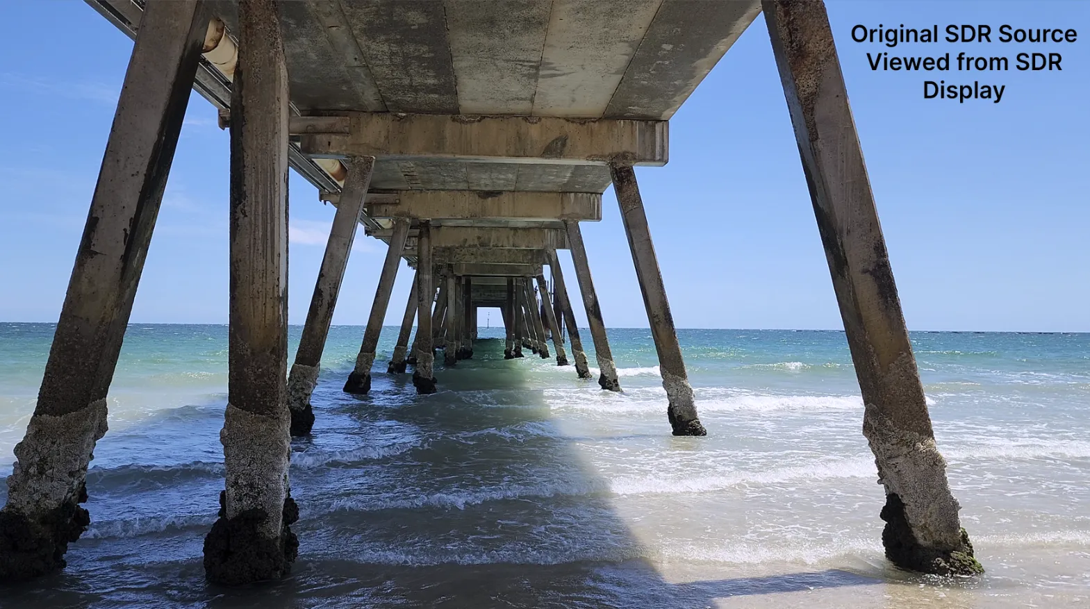

Compared to SDR, HDR holds more range in the middle gray values, shadows and pushes the brightest and darkest values further apart. The limitation, really comes down to the viewing capability with our displays.
As noted above, in order to see HDR you will need to have a display that is capable of displaying these values. Luckily the most recent cell phones, TVs, desktop monitors and some handheld gaming displays can display HDR. Though, not all HDR displays are made the same. This is something you will need to do research on your own devices to know what’s the maximum values you can actually view.

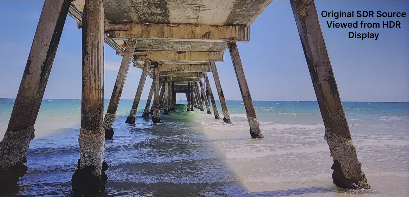

If you view an HDR video on a non-HDR display, you may see clamped/flattened values. In the example above, the highlight values appear 'clipped' because they are out of range of the display.
Viewing the same clipped HDR image from an HDR monitor you are easily able to see a wider dynamic range, most notable in the clouds.

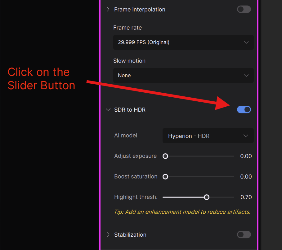

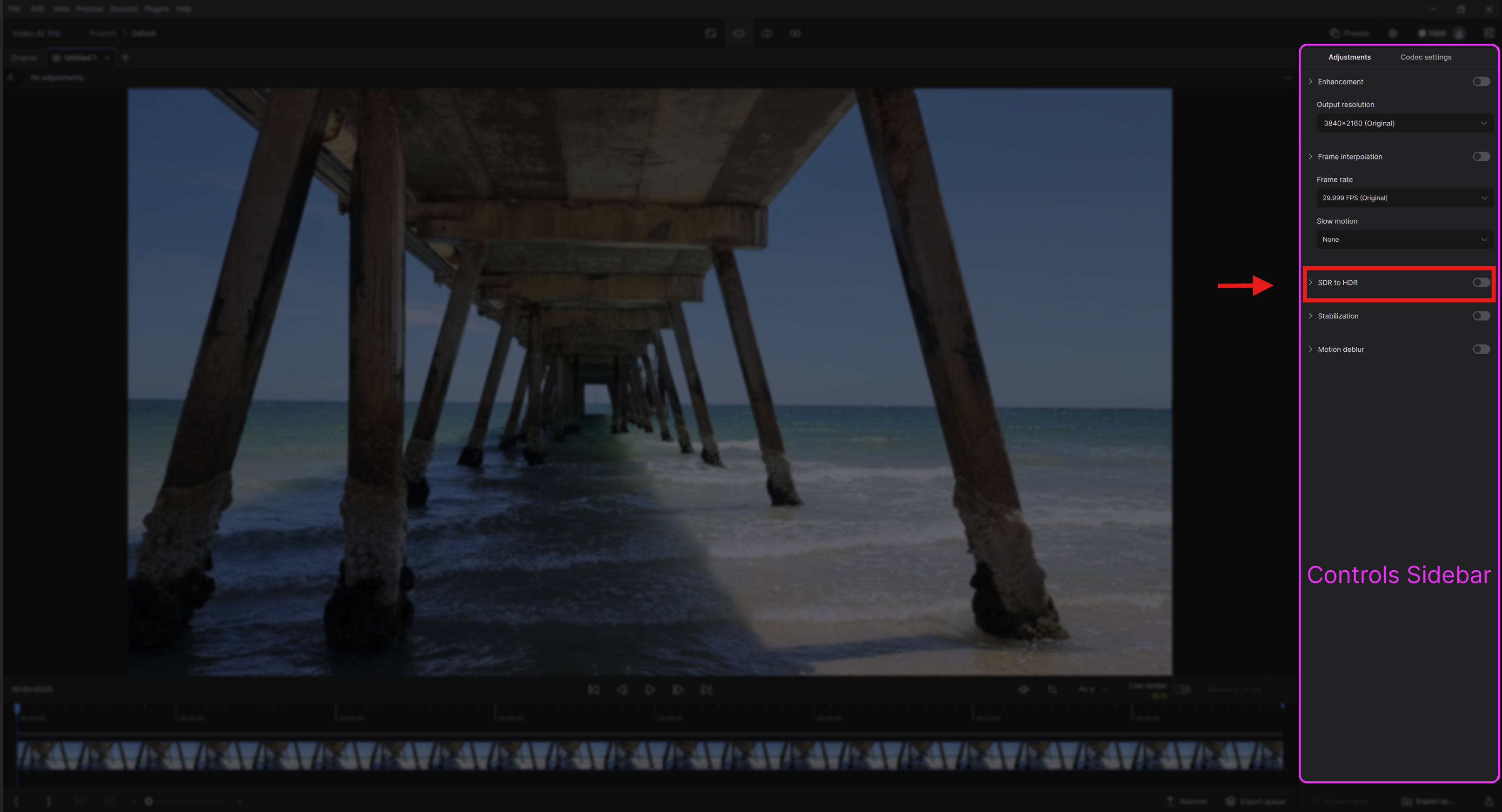

You can find the SDR-to-HDR mode in the upper screen right side of the application within the “Control Sidebar”. This is between "Frame Interpolation" and “Stabilization”. Click in the sider button for the SDR to HDR to enable and reveal a drop down menu.

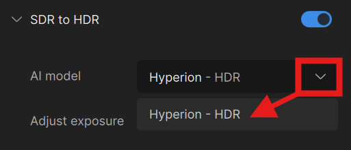

For the AI Model, clicking the carrot reveals a single AI Model. The “Hyperion - HDR (ALPHA)” is our model that does the inverse tone-mapping that increases color-depth, contrast and increased peak brightness.

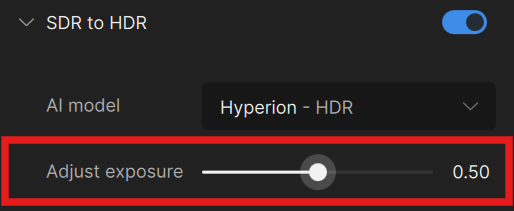

Adjust Exposure allows the user to modify the exposure from the origin starting point, which defaults to “0”, up to double the max amount value of “1”. Note that the AI Model will intelligently choose the areas to brighten based on the video content.

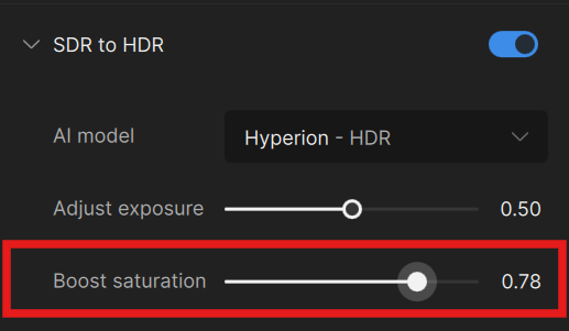

Boost Saturation allows for an increase of color intensity from the original amount at “0” up to the maximum at “1”.

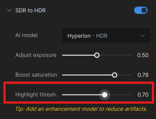

The Highlight Threshold slider sets the lowest intensity level in linear color that has been determined to be a highlight by the Hyperion AI Model.
Lowering this value could cause color shifts & large contrast changes, especially in skin tones. It is recommended to test from the default setting of 0.70. If there are any slight color shifts, raise the value, otherwise you can experiment with lower ones. The Highlight Threshold is between 0.45 to 0.85.

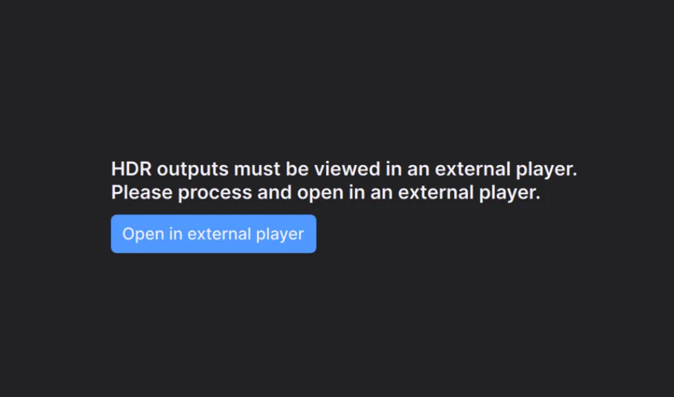

In order to view any of the parameter changes, you will need to render a preview. With the updated player in Topaz AI 5.4, you will be able to view the HDR version of your video.
