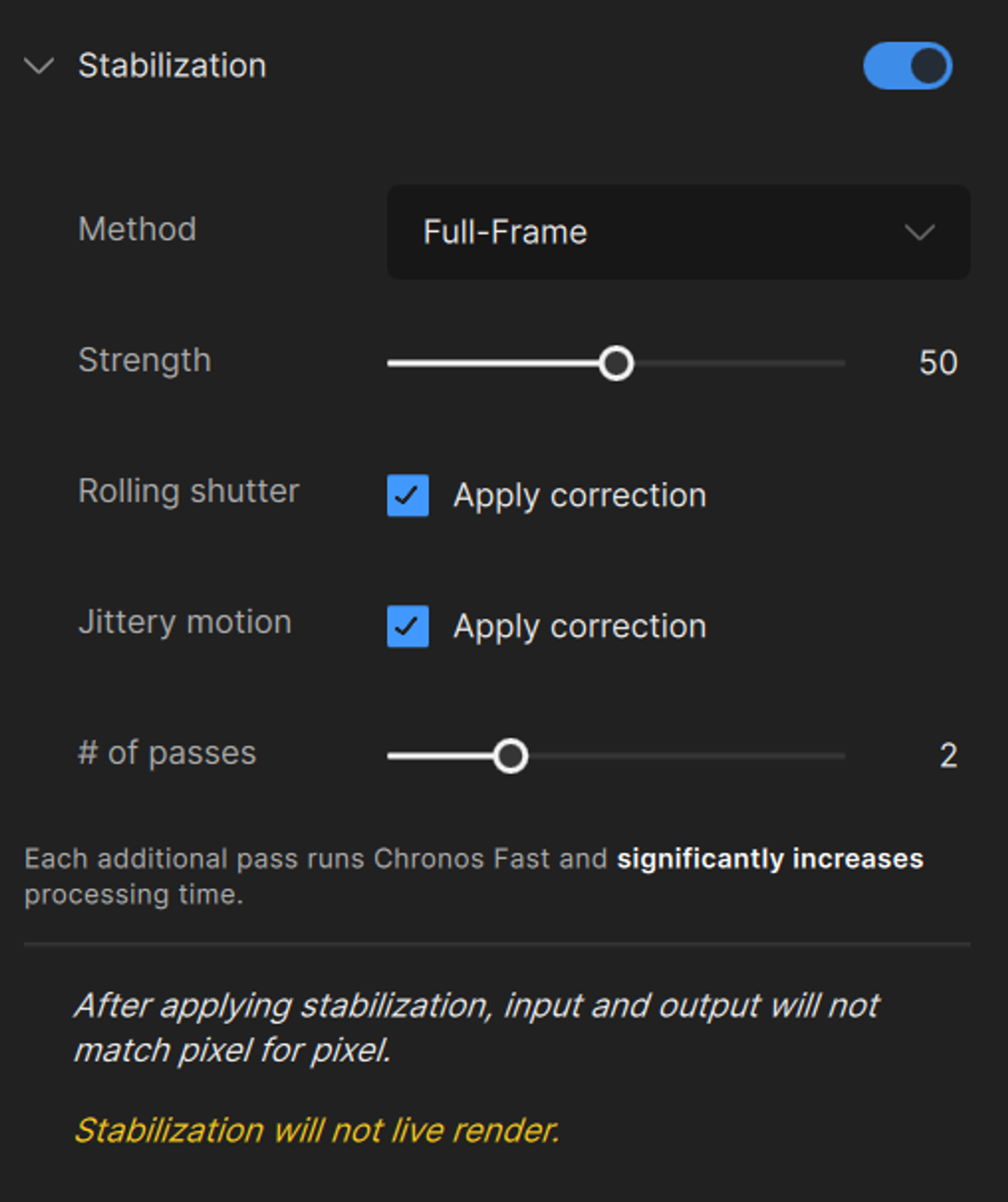

Improve video quality by removing unwanted camera shakes and jitters due to hand shaking and unintentional camera panning. This model stabilizes footage by moving and rotating the original frames to make subjects visibly stable from frame to frame.
- Input and output files will not match pixel to pixel when using this model.
- Increasing strength will result in a more stabilized output at the cost of increased artifacts (Full Frame) or a more cropped output (Auto-Crop).
Full Frame
Full-frame mode fills the blank spaces at the edges of the video using frame interpolation and deep learning.
This method preserves the original resolution but may result in blurriness on edges in some cases.

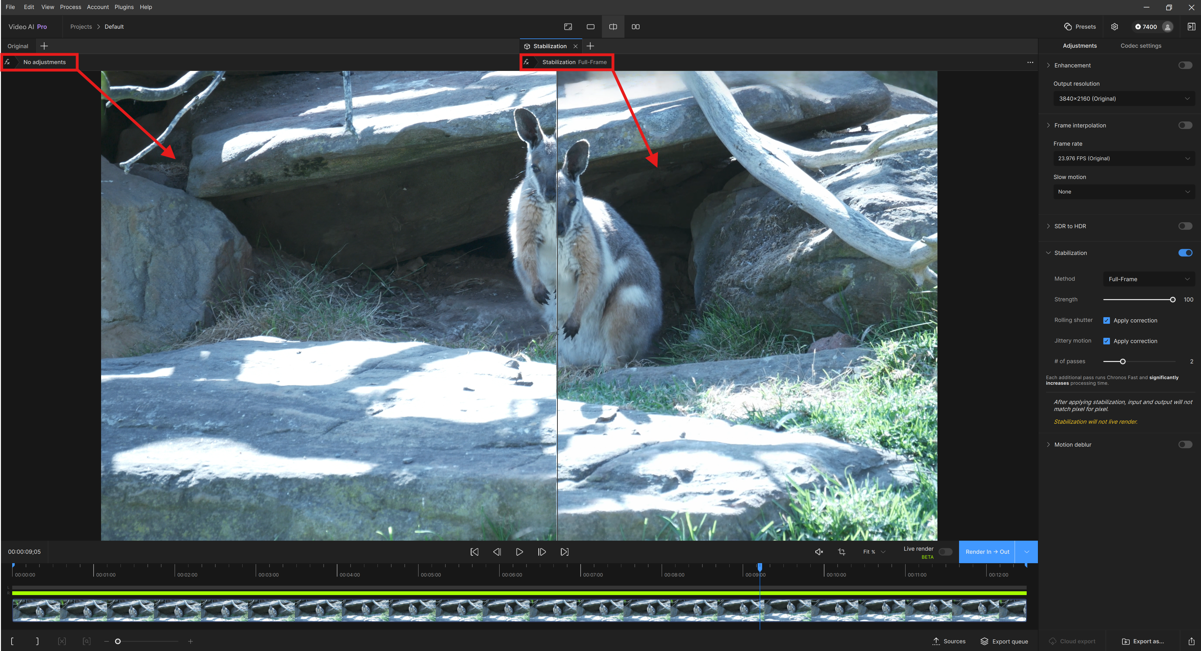

Auto Crop
Auto Crop mode will crop out blank spaces on the edges of videos, resulting in an image that is always sharp but may have a reduced resolution and frame size. In the example above, the striped portion is what will be cropped.
Difference between Full & Auto Crop
In the example above, the border of filmed data, is the visual difference between Full Frame and Auto Crop. Auto Crop completely removes a safe percentage of data that may contain artifacts from the stabilized motion. As noted, the resulting crop is based upon the amount of camera shake that is present in the original footage.
Rolling Shutter Correction
Reduces wobbly distortion caused when the camera moves too fast.
Here is an example of the same two images lined up and overlayed. There is a clear distortion with the angle and stretched appearance of the bird.
Reduce Jittery Motions
This toggle corrects parallax distortion and tilting motion by running Chronos Fast for each interpolated pass.
