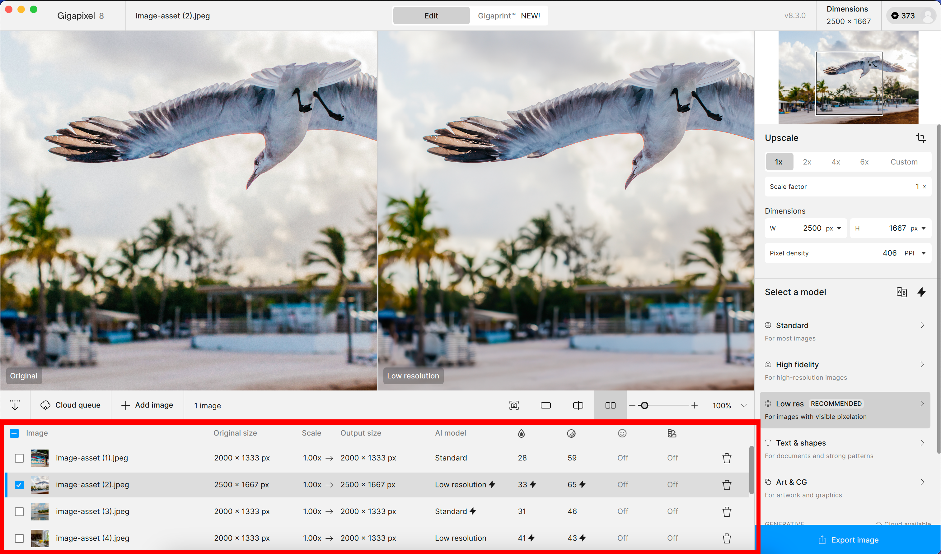

File List
Review and see changes you have made to images with the File List located at the bottom of the Gigapixel AI screen.
File List View Expander
There are two ways to expand or collapse the file list.
1. Manual Expander
Hover on the black line that separates the Preview and the File List. The line changes to blue. Click and drag the file list to the desired location across the preview.
2. Fixed Expander Button
Locate the arrow button on the left side of the "Add Image" button.
Click on the arrow to collapse the file list. Use the same button to expand the file list. The default shows four files expanded in view.

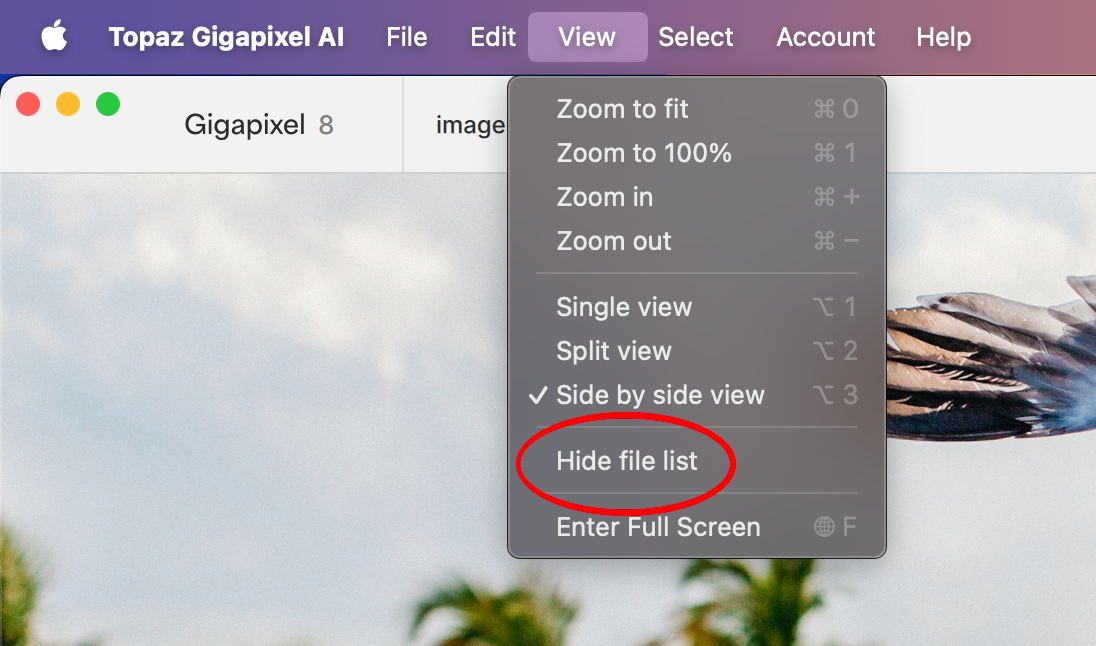

You can also choose the fixed expander button in the Gigapixel Main Menu, select View > Show/Hide File List

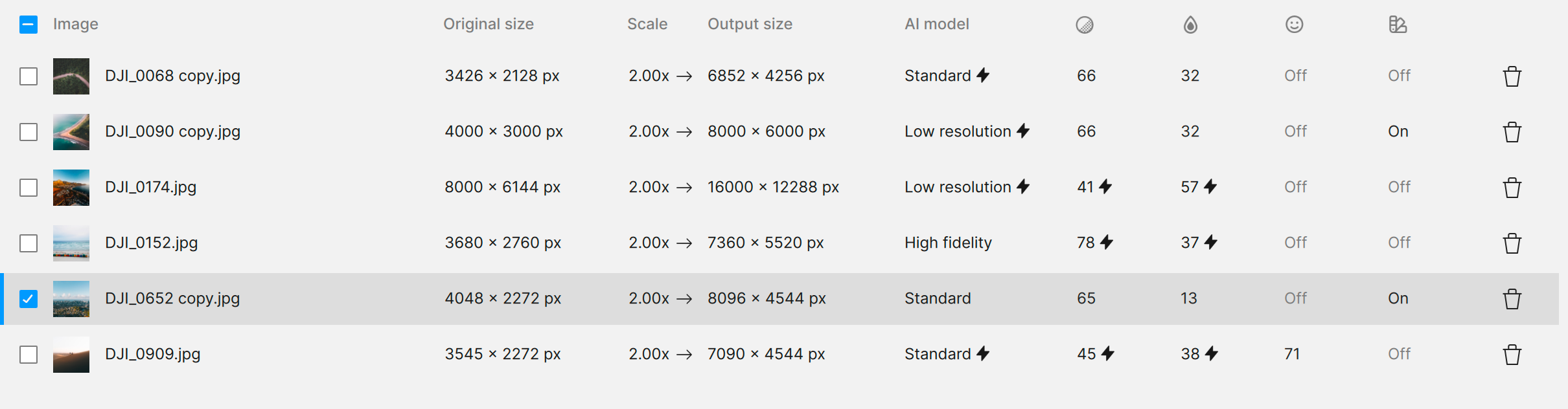

How to Read the File List
Use the file list to compare and review what settings you have applied.
The file list is broken down into several smaller categories:
  • Name - Files will be shown in Alphabetical order. When additional images are imported after already using the app, these files will be shown at the bottom of the file list.
  • Original Size & Output Size - The before and after file size after upscaling or cropping - these values will change based on your Resize Mode settings.
  • Scale - the multiplier by which your image is upscaled
  • AI Model - Whatever model is used to enhance the file, the name will be displayed in color. Each AI Model has its own designated color.
  • Denoise - The strength of how much noise is suppressed is indicated by a number value.
  • Sharpen - The intensity of how much sharpness is added from the image is indicated by a number value.
  • Face Recovery - When face recovery is turned on, a number value will appear. The intensity of how much Face Recovery strength is used is indicated by a number value.
  • Gamma Correction - "ON" appears when Gamma Correction is applied. "OFF" appears when Gamma Correction is not applied.

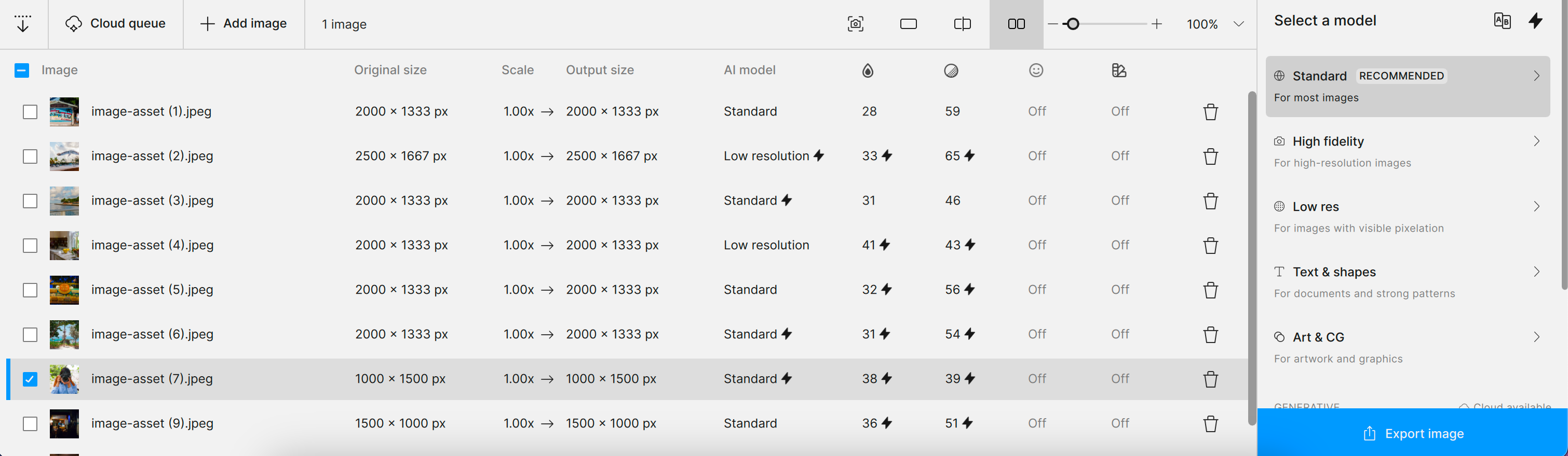

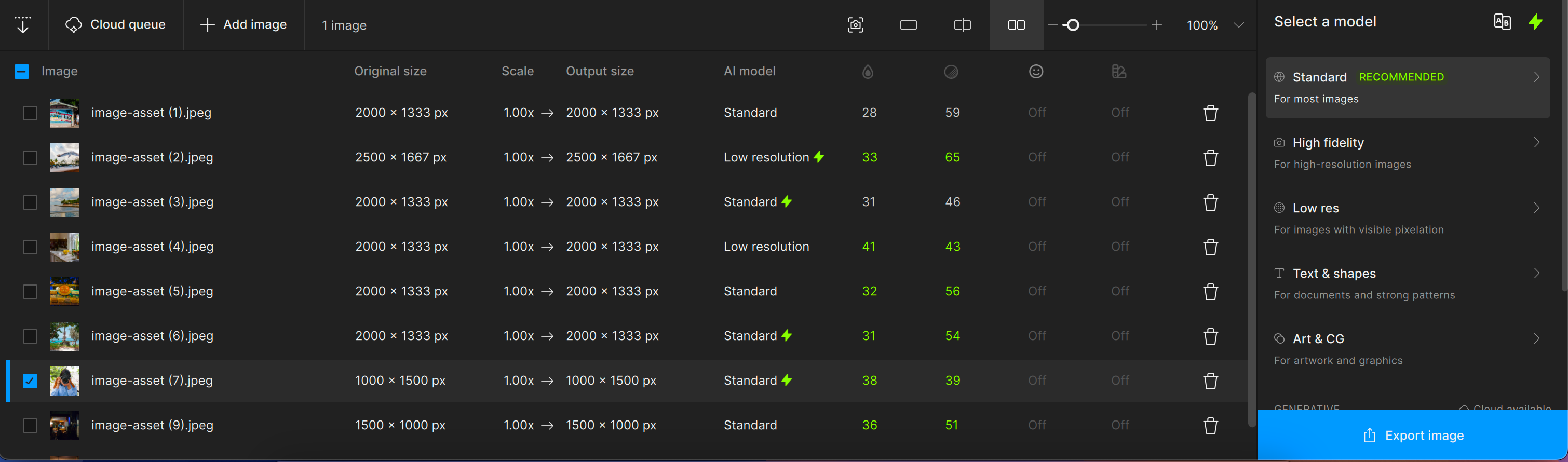

AUTO MODE
When the user interface is in the Theme: Dark mode, a green Thunderbolt symbol indicates when the 'Auto' setting is applied in the Filters Panel. This setting only applies to the AI Models or Settings.
In light mode, the thunderbolt appears black.
Green numbers indicate values from refining Denoise & Sharpen.
