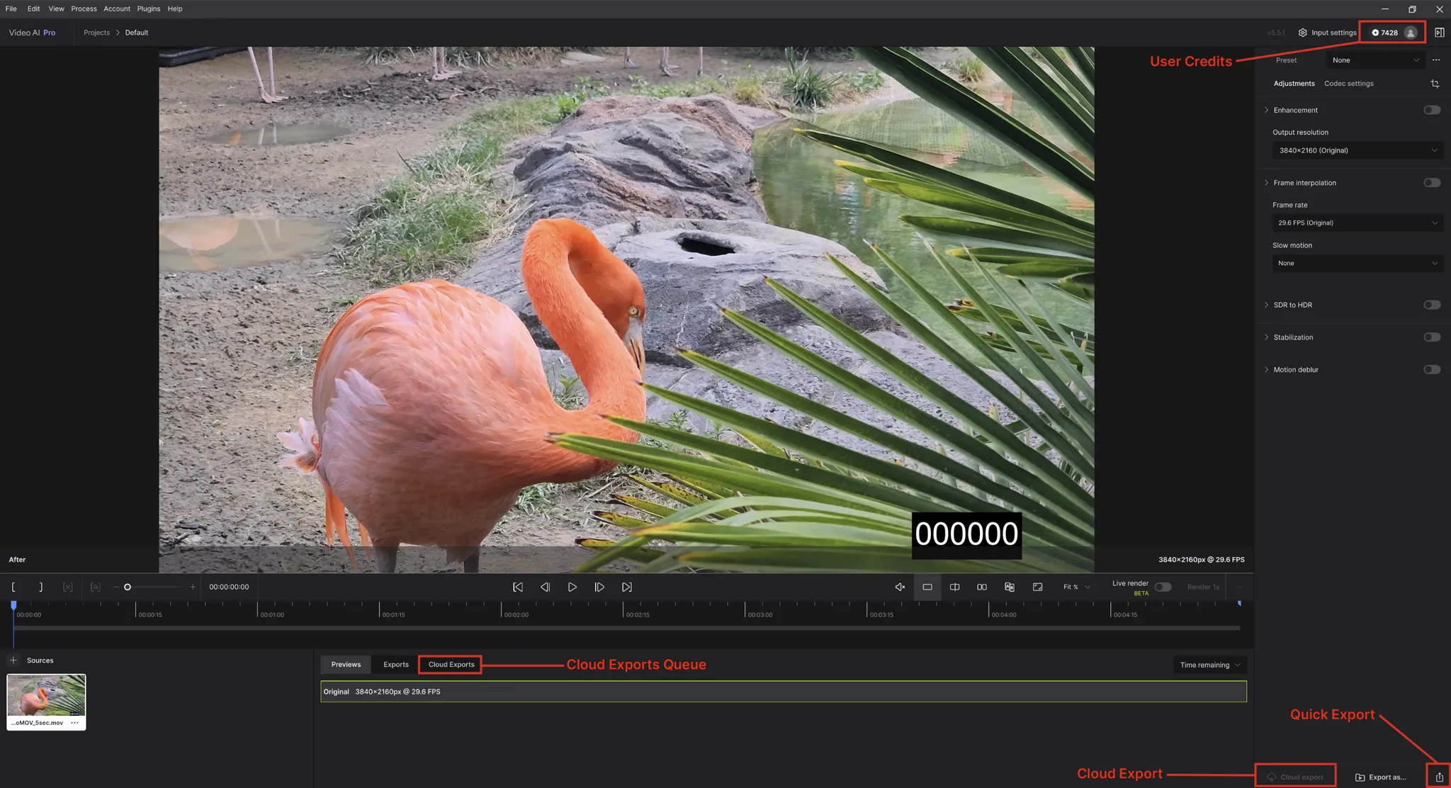

Layout Update
With version 5.5, there are a few new updates on the layout to take note of.

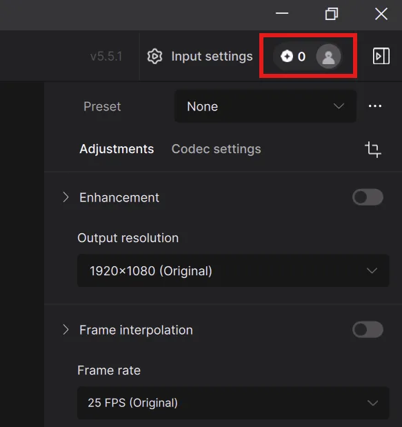

  • User Credits can be found in the upper screen right corner of the “Controls Sidebar”.
  • Quick Export is now represented as a share icon on the lower most screen right corner of the “Controls Sidebar”.

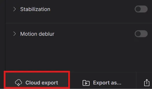

  • Cloud Export is at the bottom of the “Controls Sidebar”, just left of the “Export as…” button. This optional service can be disabled via the Preferences menu.
  • Cloud Exports Queue just below the timeline, shows all current Cloud Rendering tasks. This follows the same logic as the standard Previews and Exports Queues.

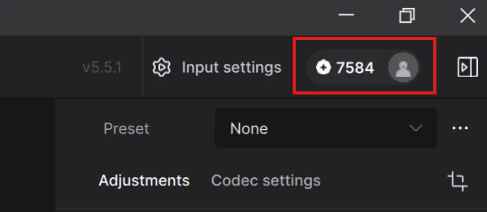

You will see a coin icon next to the Input settings in the upper screen right corner. The number represents how many credits you have. In the image below, this user has “0” credits.

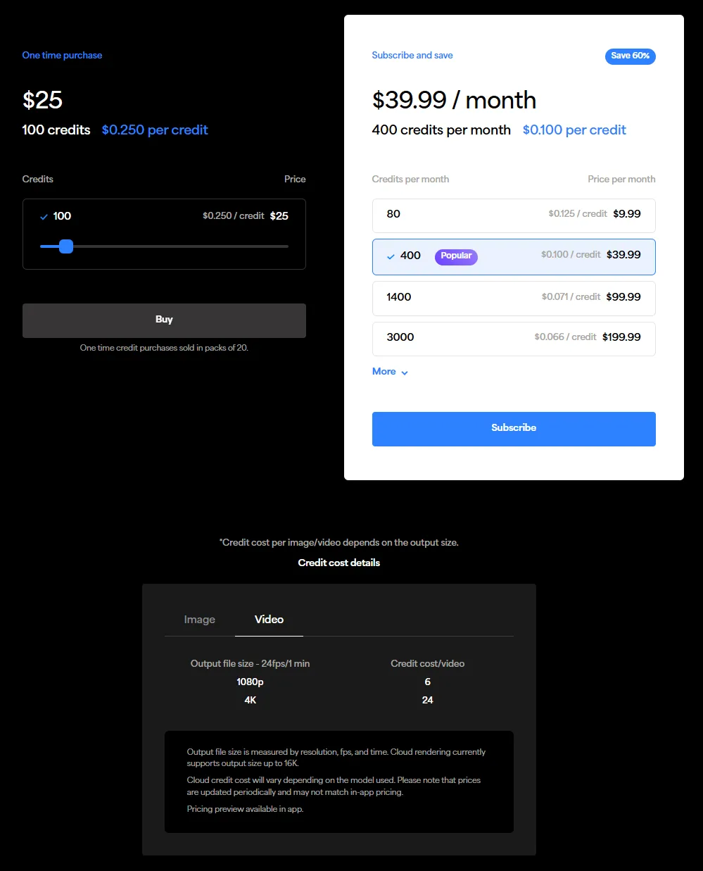

In order to use Cloud Rendering, you will need to purchase Cloud Credits. Cloud Credits can be purchased here. This will take you to a webpage where you can purchase specific amounts of credits or sign up for a monthly credit plan.
Once you make your credit purchase, you will need to close and reopen the Video AI application if it was open during the transaction.

Once you are content with your video enhancement settings and preview(s), you can click on the Cloud Export button.

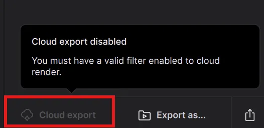

If you attempt to export to the Cloud without a filter enabled, you will notice that the button is greyed out and you will get the following message if you rest your mouse pointer over the button.

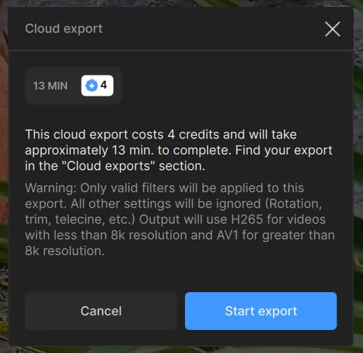

Upon pressing the Cloud Export button, you will get a pop up "Confirmation" text menu.
This “Confirmation” menu provides the following:
  • Estimated render time upon actual processing. Please note that this is an estimate and should not be assumed to be 100% accurate.
  • Display the cost twice. Once next to a blue coin and again on the highlighted text.
  • Warning Note, this gives a basic description on the current conditions for Cloud Rendering.
  • Cancel button, allows you to prevent sending anything to Cloud Rendering. No credits will be charged as nothing was submitted.
  • Start Export button, confirms your understanding of the Credit cost and the noted warning.

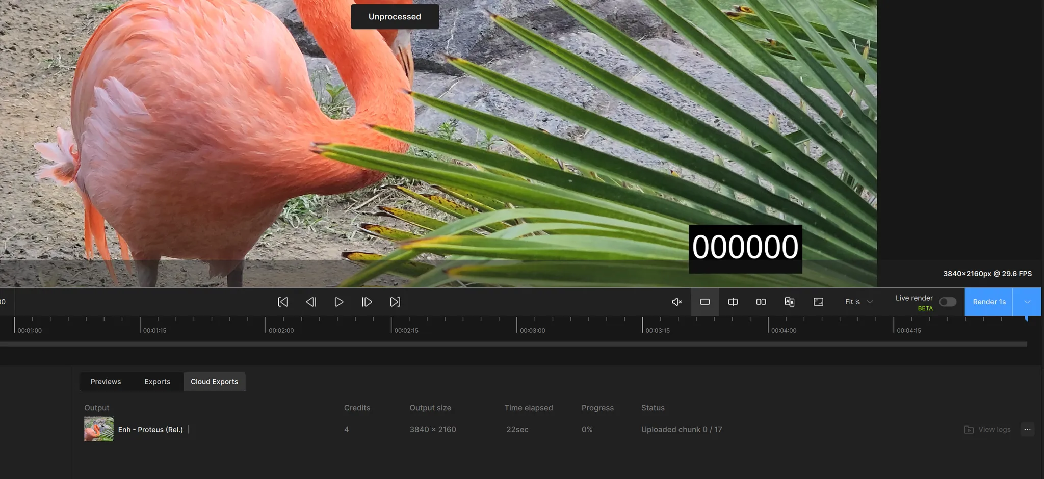

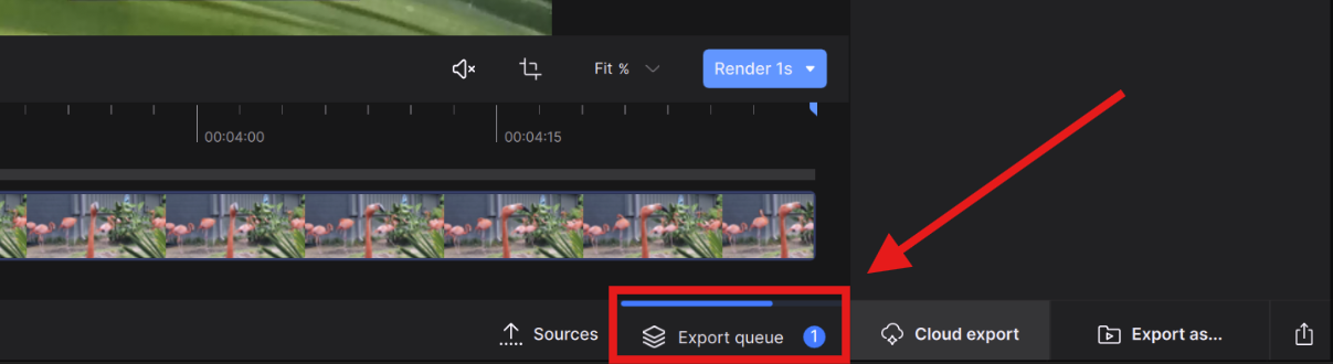

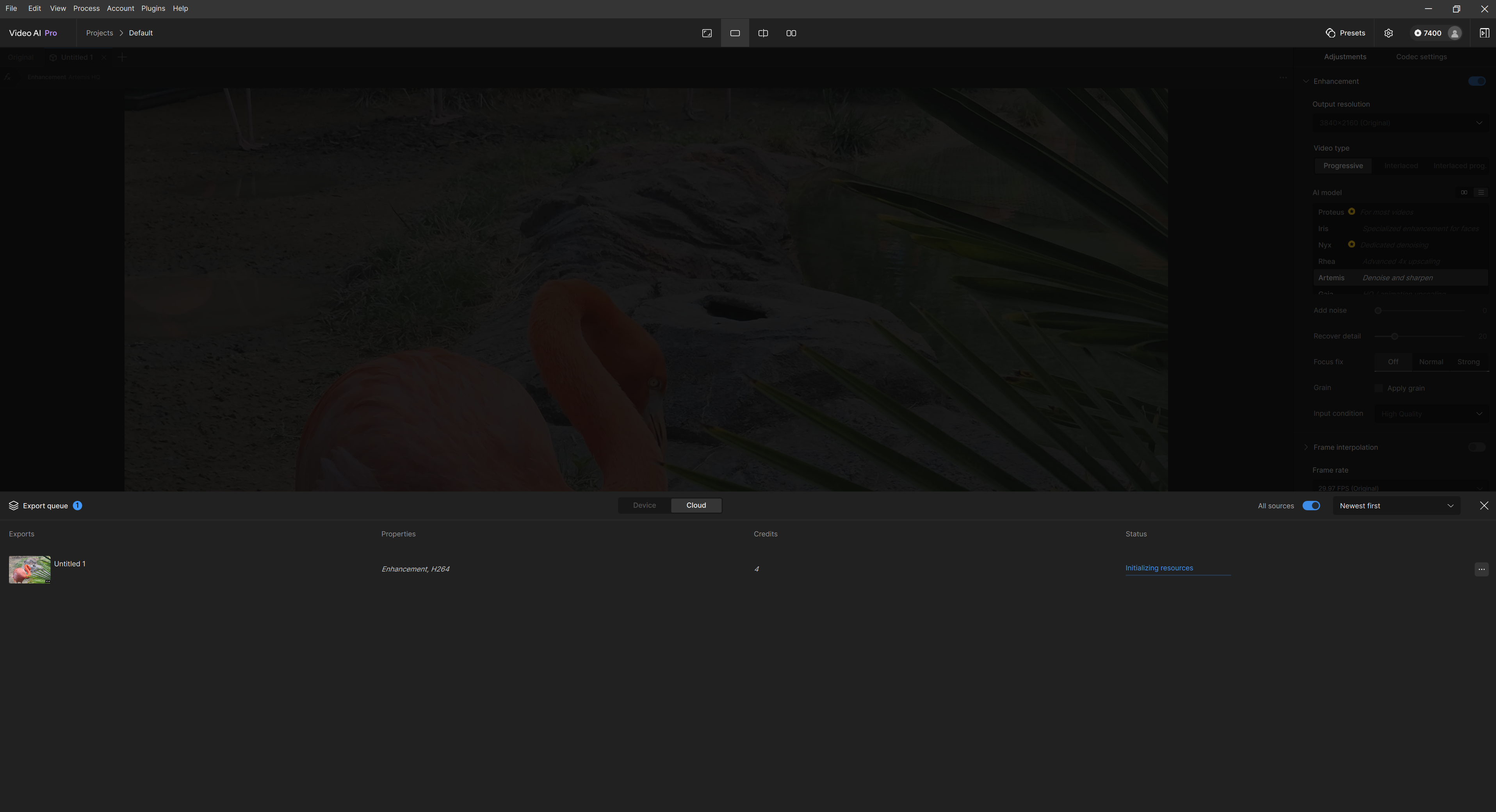

Cloud Export Queue
Once Start Export is selected, there will be a small indicator over the Export Queue.
Double click on the Export Queue to open the Cloud Export Queue.
  • Output: Shows the video clip that’s rendering on the cloud.
  • Credits: Displays the total credits spent on the render.
  • Output Size: Shows final output resolution.
  • Time Elapsed: Displays the time from the moment the Start Export button is selected. This does not represent the actual rendering time, but the entire process including upload time.
  • Progress: This will show the progress of the render once the job is done uploading.
  • Status: This lets the user know at what stage the video is moving through or display any failures and completion.
    • Uploaded Chunk: Uploading/mounting video to the cloud and to the rendering servers.

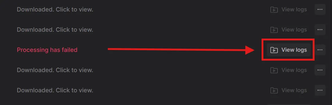

    • Red Text: Anything in red text is a failure. A brief description can be found here.
    • Download Available. Click to Download: Click on the text to download the video file.
    • Downloading… : Process of retrieving your video from the cloud to your personal machine.
    • Downloaded. Click to View: Click on the text to view your render in an external player.

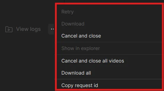

If you come across any errors during renders, the View Logs folder icon will be highlighted. You can click this button to copy and export logs when reaching out to Support.
Next to View Logs, there are three dots with additional options. Clicking on this will open up a drop down menu.
  • Retry: If there is an error with your file, you can retry the render. Please copy any logs before restarting as you may need this for troubleshooting.
    • Once retry is selected, the app will clear the existing logs. You will only get billed for a completed rendered process. So if your job fails halfway, you will be credited back.
  • Download: If you haven’t downloaded your video from the Status Text, you can download from here.
  • Cancel and Close: This clears the specific job from the Cloud Exports Queue and cancels the job.
  • Show In Explorer: If you have downloaded your Cloud Render, this will open the folder where the job has been delivered.
  • Cancel and Close All Videos: This clears all the jobs from the Cloud Exports Queue and cancels them all.
  • Download All: If you haven’t downloaded your multiple videos from the Status Text individually, you can download all of them from selecting this option.
  • Copy Request ID: This is the Cloud Render ID. You may need this for personal record keeping or if you need additional support.
