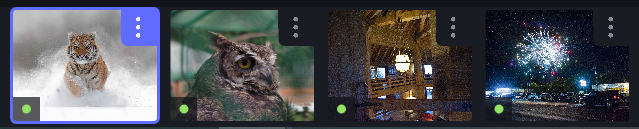

With Autopilot
Import your images to Topaz Photo AI. By default, all images will have a green dot on the bottom left which indicates Autopilot is on.
Batch processing with Autopilot works best if you have personalized Autopilot to your liking through the Preferences menu. Click here for instructions on configuring Autopilot.
Autopilot On
Click the Save button and start the batch. Autopilot will select the best filters when it begins to process each image in the queue.

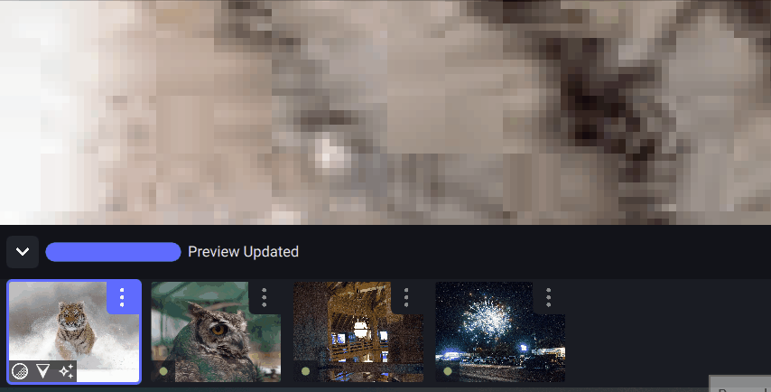

  1. Import your images to Topaz Photo AI.
  2. Make your manual adjustments on one image.
  3. Right click the image or use the three dots to select Apply > Current Settings to All.
This copies the settings from one image to the entire batch.
Apply Settings to All
Click the Save button and start the batch. Every image in the batch will use the same adjustments.
