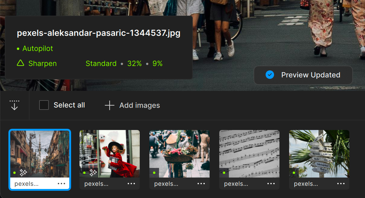

With Autopilot
Import your images to Topaz Photo AI. By default, all images will have a green dot on the bottom left which indicates Autopilot is on.
Batch processing with Autopilot works best if you have personalized Autopilot to your liking through the Preferences menu.
![Autopilot On](https://cdn.sanity.io/images/r2plryeu/production/94e3883b0d33e656c5fc4a3775c271196d2d11ed-1212x658.png?q=90&fit=max&auto=format)
Click the Save button and start the batch. Autopilot will select the best filters when it begins to process each image in the queue.

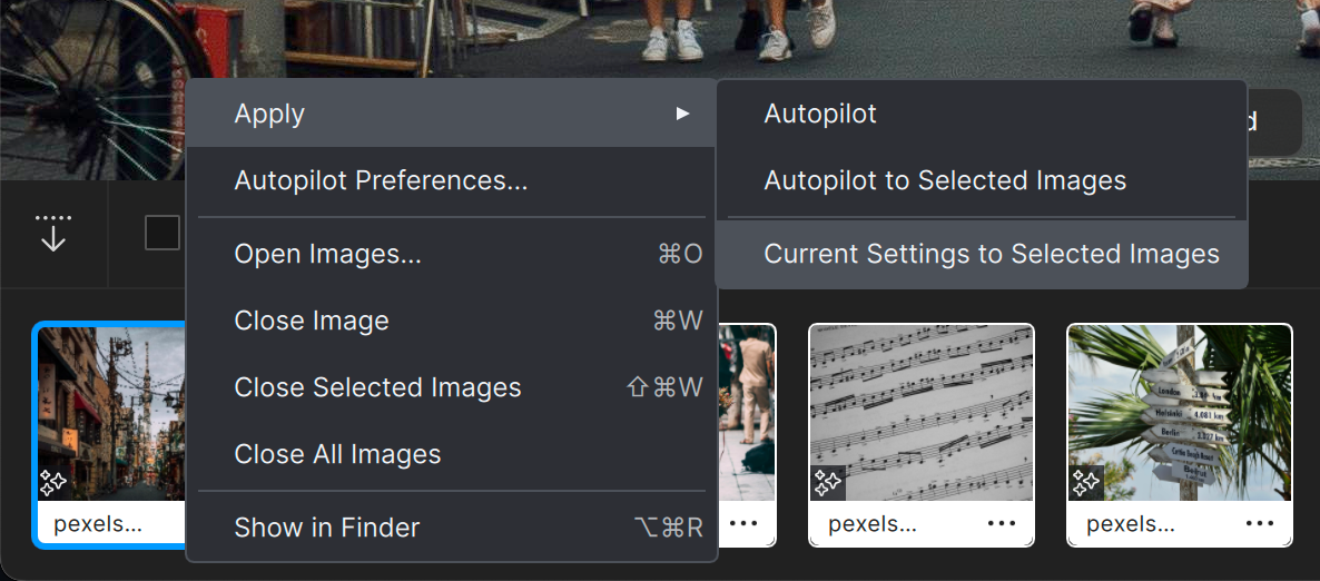

Apply Settings to All
This is best for batches of images that are in similar lighting conditions or created the same way.
- Import your images to Topaz Photo AI.
- Make your manual adjustments on one image.
- Ctrl + A to select all images in the batch, or Shift + click to select some images from the batch.
- Right click the image or use the three dots to select Apply > Current Settings to All.
This copies the settings from one image to the selected images.
![Apply Settings to All](https://cdn.sanity.io/images/r2plryeu/production/fda9d42985fe2cf67d6b290cb2757476b2fe3b2b-1186x522.png?q=90&fit=max&auto=format)
Click the Save button and start the batch. Every image in the batch will use the same adjustments.
