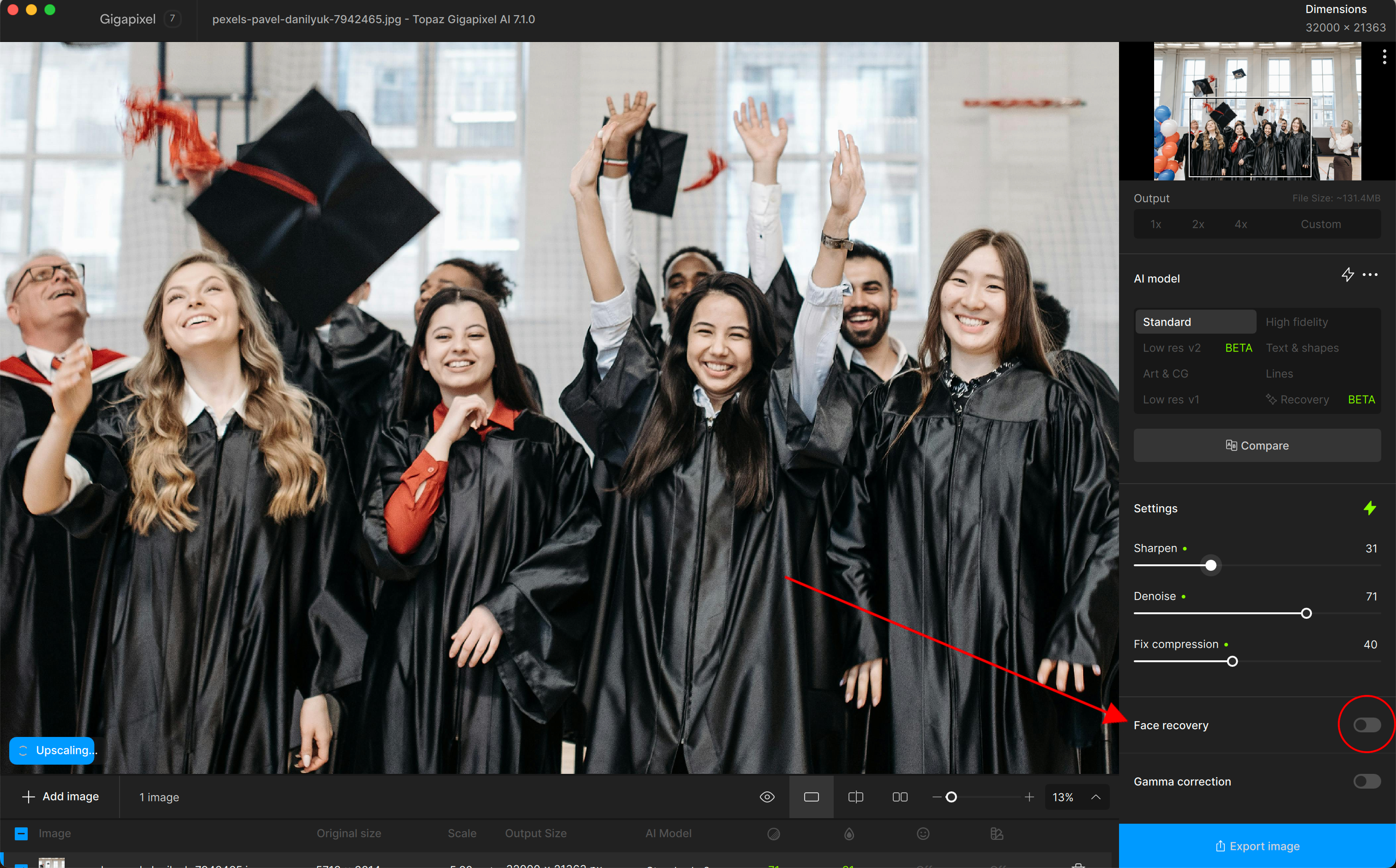

In Additional Settings, click the toggle switch to activate the feature.
![image](https://cdn.sanity.io/images/r2plryeu/production/d69924de9952d523ee1ae1bbe3917244c4bb2de9-3024x1881.png?q=90&fit=max&auto=format)

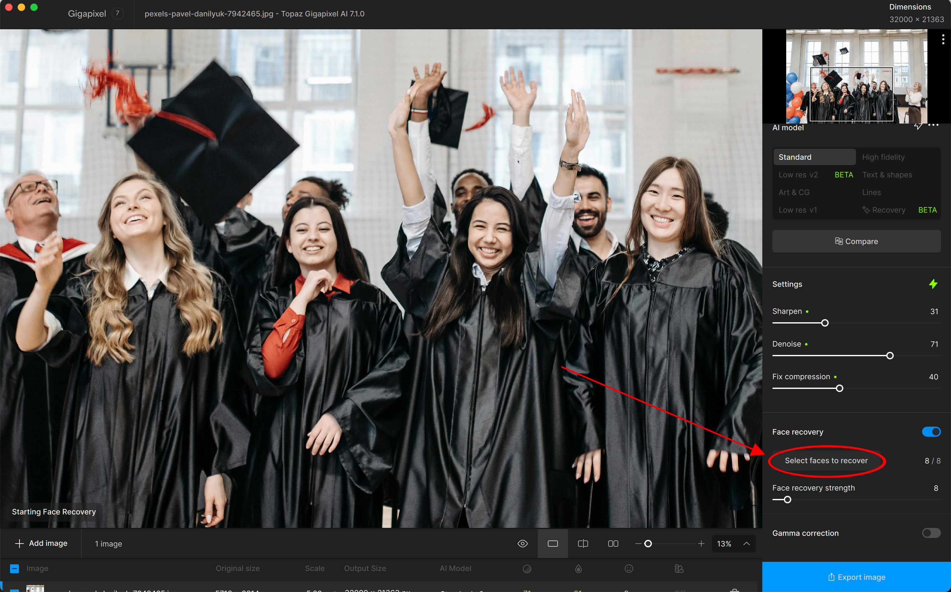

Click on the button Select Faces to Recover to enhance.
![image](https://cdn.sanity.io/images/r2plryeu/production/3aef560ad67b28dd4a9c02739f5eacf2b4cba84d-3024x1883.png?q=90&fit=max&auto=format)

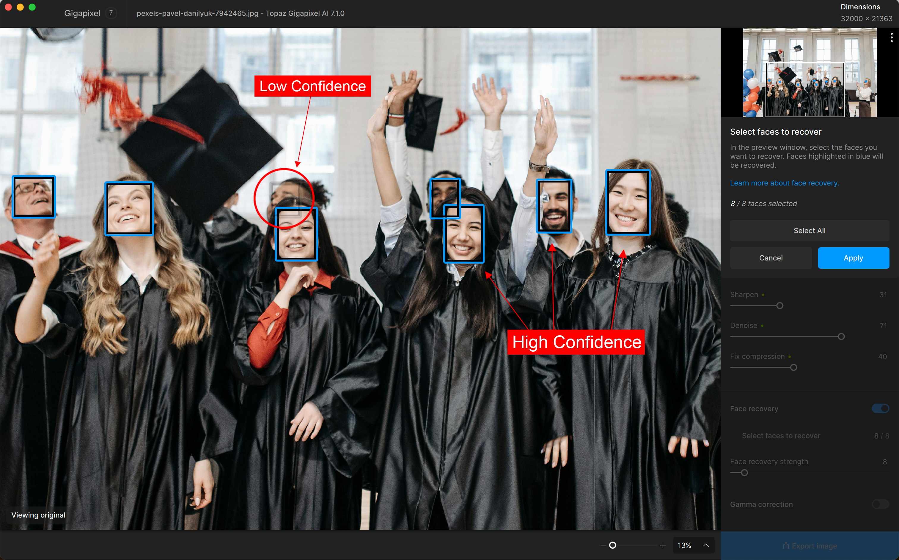

In the Preview, the image shows boxes around faces that the AI has detected. Click on the desired boxes that need enhancement.
A blue colored box indicates High Confidence.
A gray rectangle indicates Low Confidence.
![image](https://cdn.sanity.io/images/r2plryeu/production/bf6351539ce1a62342b10519247449d1571952d8-3024x1884.png?q=90&fit=max&auto=format)
Click on the Low Confidence face if you wish to include it in the Face Recovery enhancement. You can also click on High Confidence faces if you do not want these to be enhanced.
