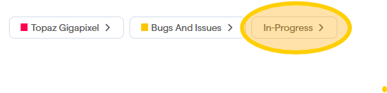

Review our Community Forum. Issues will be under the In-Progress and Resolved sections, and workarounds or solutions will be posted.
Known Issues reported by users are in the "In Progress" Section of our Forum:
In-Progress | Bugs and Issues Forum

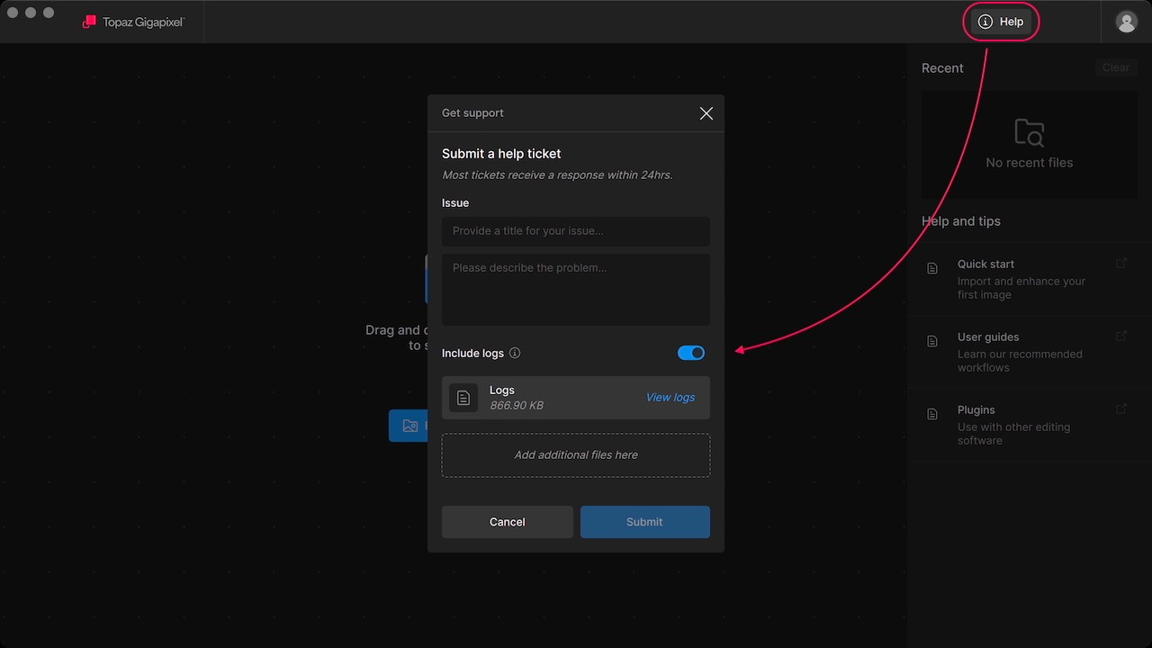

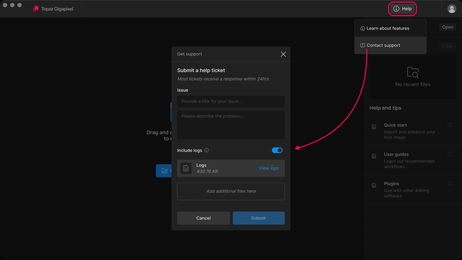

If you encounter a new bug or issue with Topaz Gigapixel, contact us by submitting a support ticket through the Help > Contact support button.
If you're unable to access the automated ticket submission, write to us at help@topazlabs.com. This will create a support ticket with our team.
When contacting us, please include:
- What Topaz Gigapixel version are you using?
Top of the app will mention the version - What email was your license purchased with?
Review your confirmation email for an order #TS-XXXXXXX - Describe the bug/issue and behavior you have encountered.
Give as much context as you can - Describe your workflow.
File type? Plugin or Standalone? What are you trying to accomplish? - Please share screenshots, before & after comparisons if necessary.
- Your System Profile.

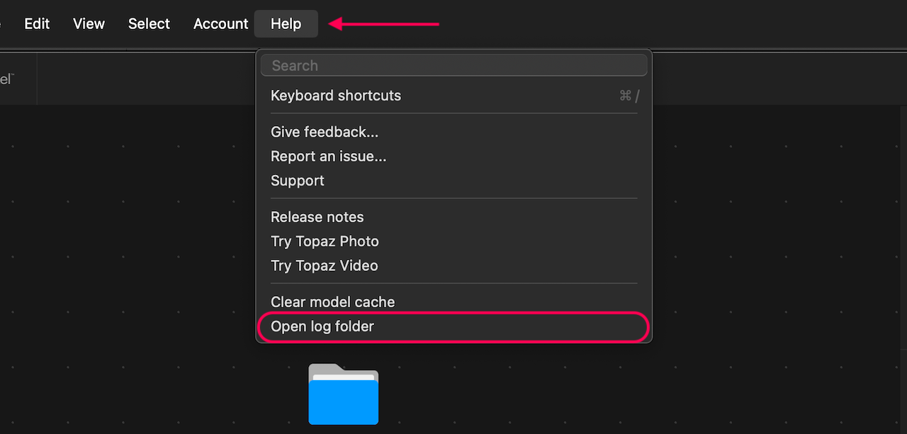

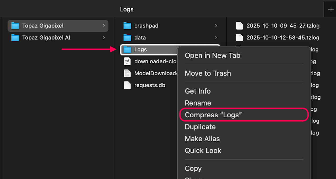

Instructions for Mac | Instructions for Windows - Logs: Go to Help > Open Log Folder. Zip the entire folder and send us the zipped file in your email. If your app immediately crashes, we can send you instructions for manually accessing the logs.
