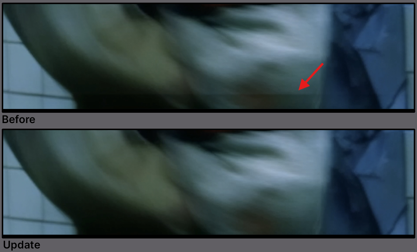

Additionally on some very rare occasions some have experiences an issue of the lower edge of the frame to have a horizontal edge. This update also addresses this.

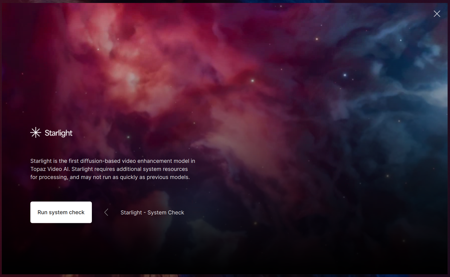

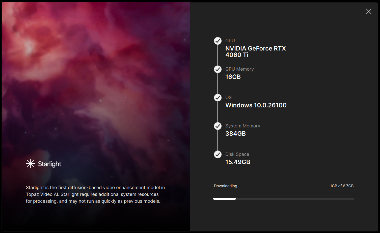

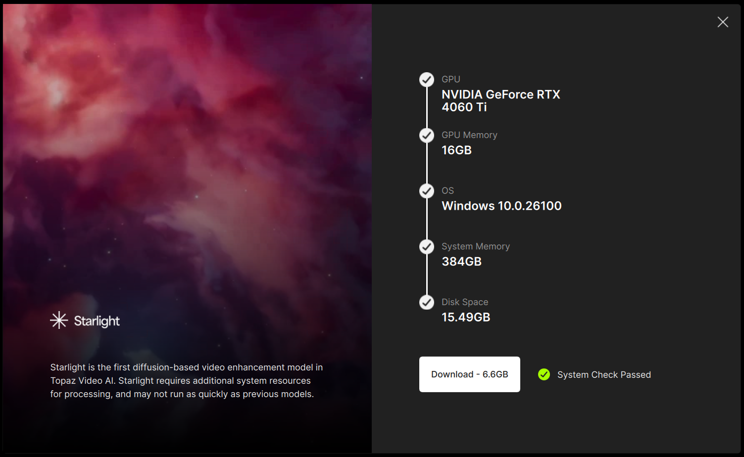

  • (For this section this is for versions prior to 1.6) If this is your first time using Starlight Mini, a pop up menu will appear (NVIDIA only). This will run a system check on your machine to see if it is capable of running Starlight locally. Click on the “Run System Check” button.
  • This will give you a visual check mark for every step that’s required. Otherwise you’ll get an “x” that identifies if there is an issue with the machine to prevent the large download for this Model.
  • Once all the necessary checks are approved, you can then press the Download button.
  • Once completed you can close out of this menu.

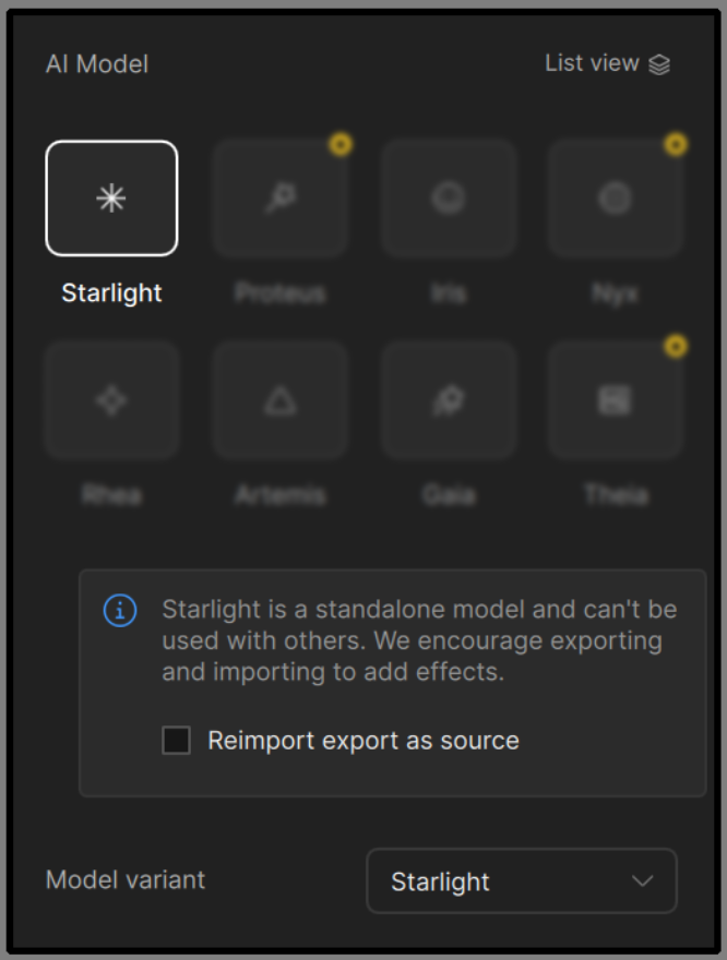

  • Assuming that you’ve already installed Starlight Mini, when this model is selected, you will be presented with the following notification:

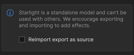

Essentially, you can only use this AI model without any other enhancements nor filters. Your machine will be working very hard with Starlight alone.
  • Note that there is a Re-import export as source button. Check the button to re-import the video. Once the render is complete, the result is essentially used as a new source. Here you can control additional enhancements, rescales and filters.

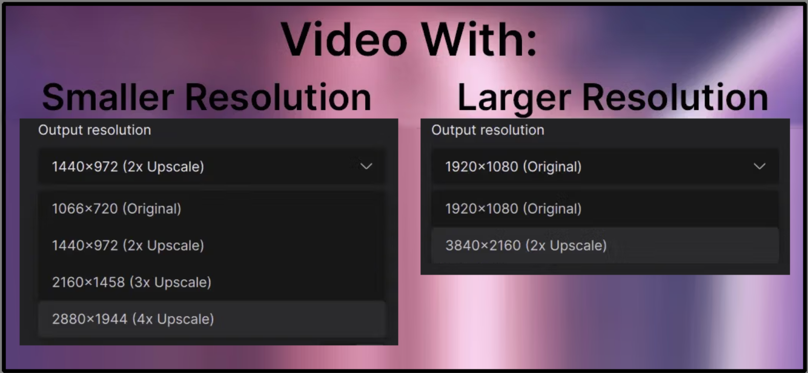

  • Starlight local shows different options for resolution output from the model, based on the resolution of the input video.

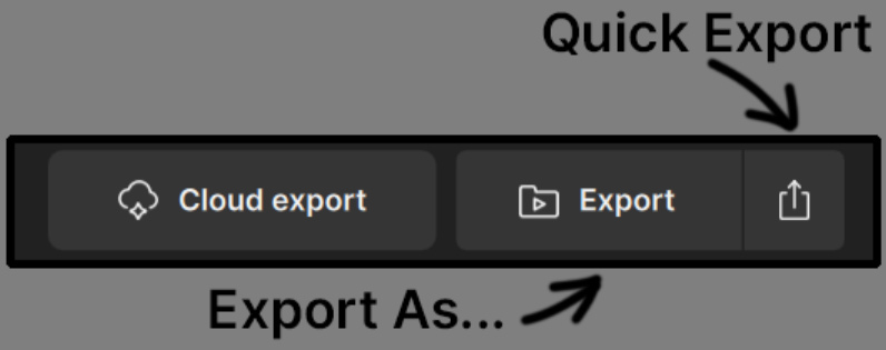

  • Once a resolution is selected, either export locally with Export as... or use the Quick Export button.
  • Alternatively, the user can utilize the Cloud Export.
