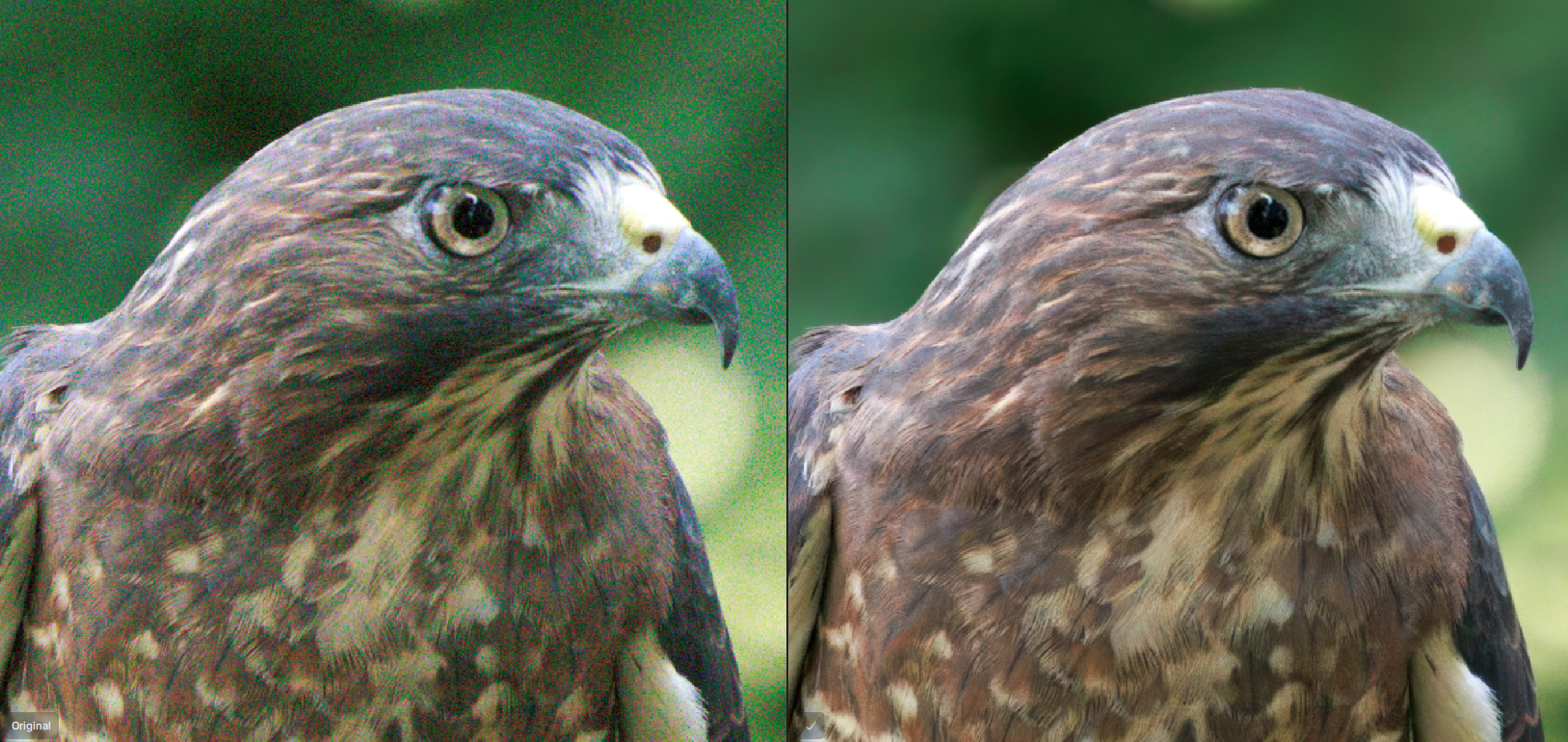

Below is RAW Denoise applied, shwing all RAW noise and all hot pixels removed.
