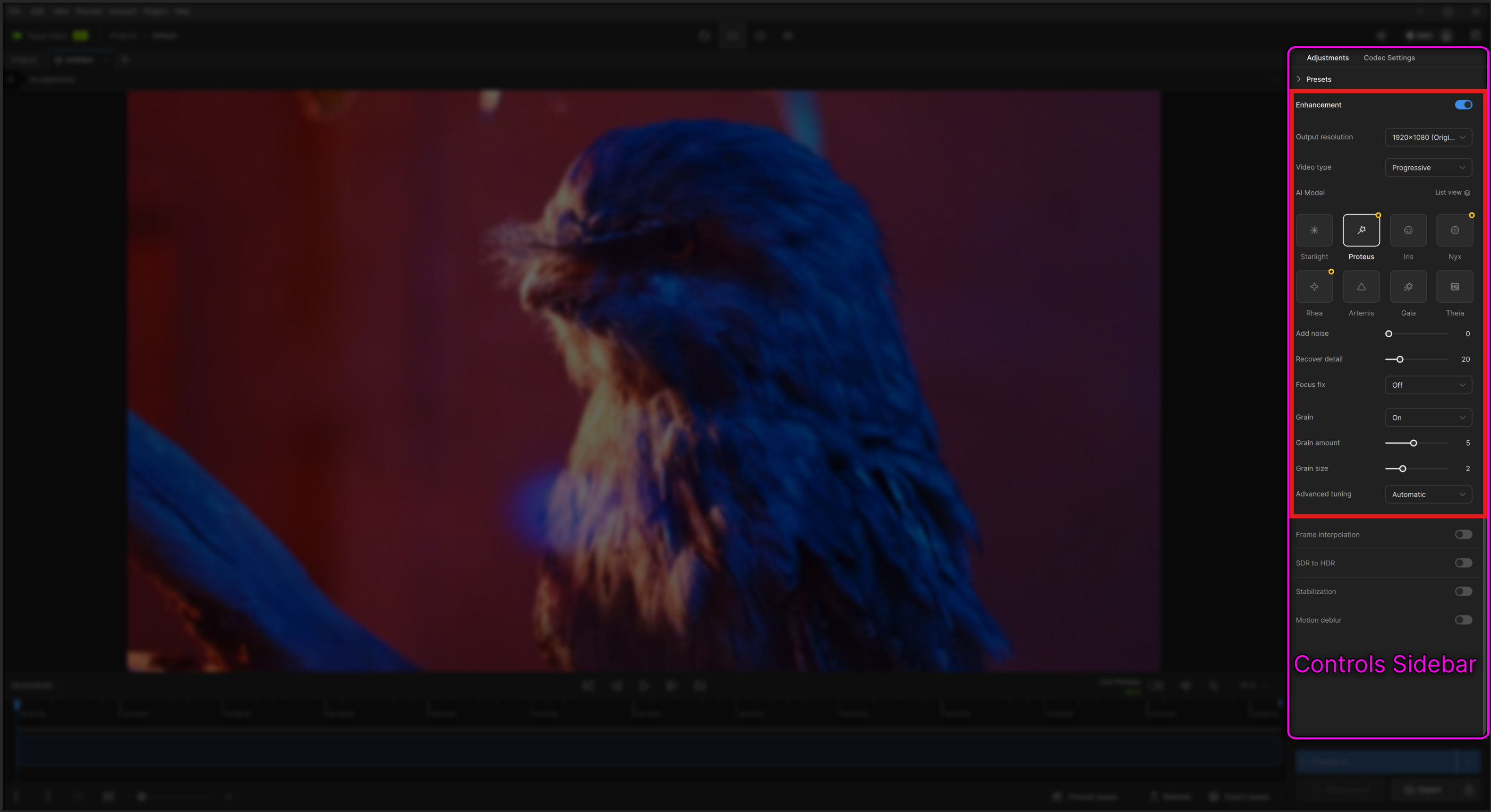

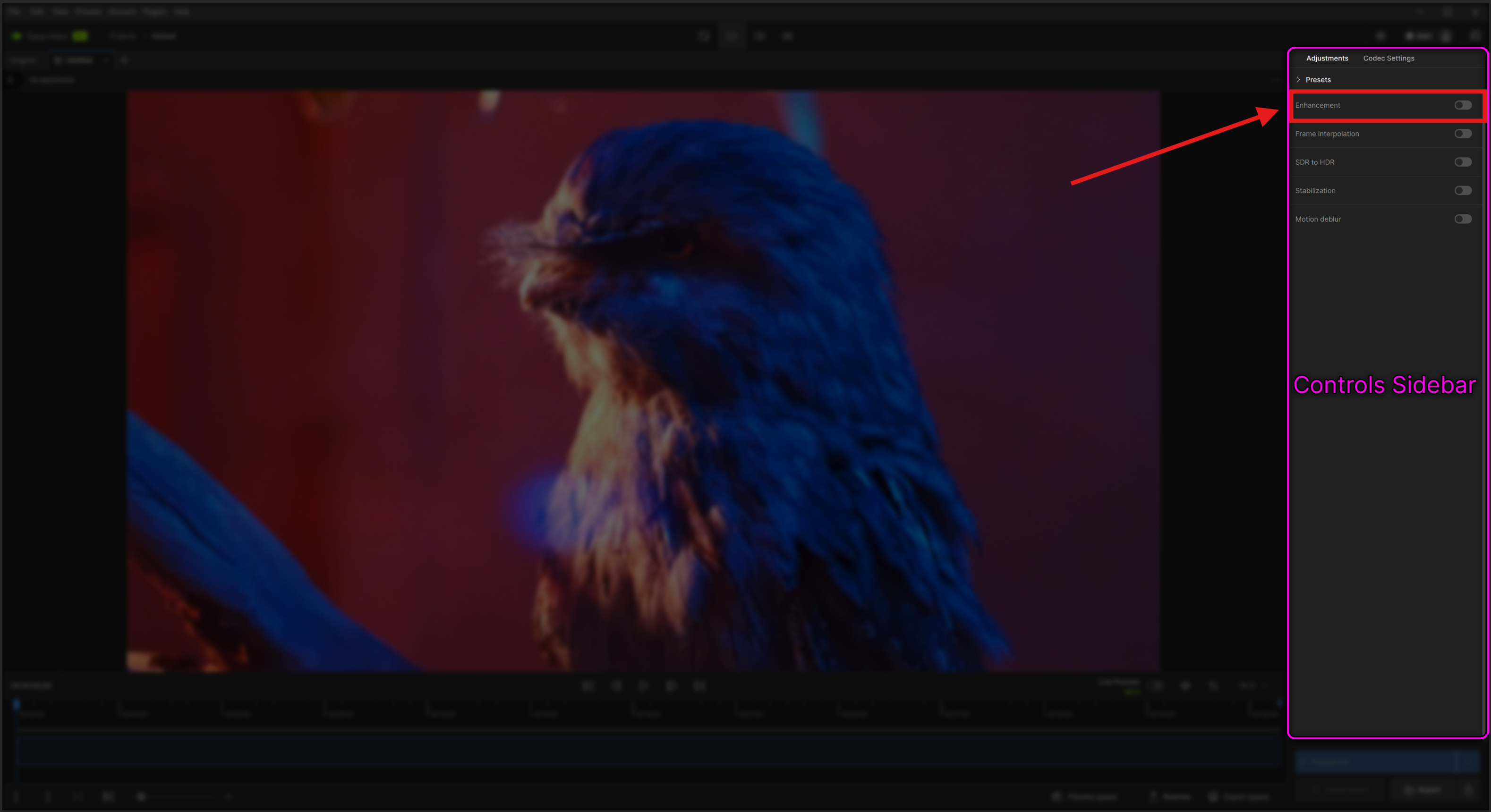

You can find the Enhancement menu on the screen right side in the Controls Sidebar.
To open the Enhancement controls, click the activation toggle. Normally this is already enabled.

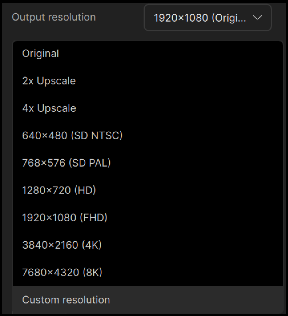

Output Resolution
The Output Resolution section allows you to select the final dimensions of your export. Click on the drop-down menu to reveal all the options available, including a custom selection at the bottom.

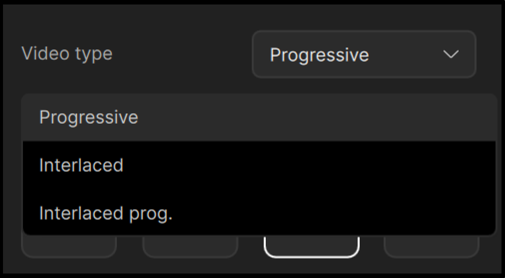

Video Type
In the Video Type section, you can set the Enhancement filter to match the type of footage you are processing. Changing this setting will list AI models that can be utilized with the selected Video Type.
  • Progressive: Enhance and upscale without deinterlacing. Most modern digital videos are progressive.
  • Interlaced: Deinterlace, enhance, and upscale footage with a combined model.
  • Interlaced Progressive: These filters are trained for interlaced videos that were previously transcoded to progressive without deinterlacing.

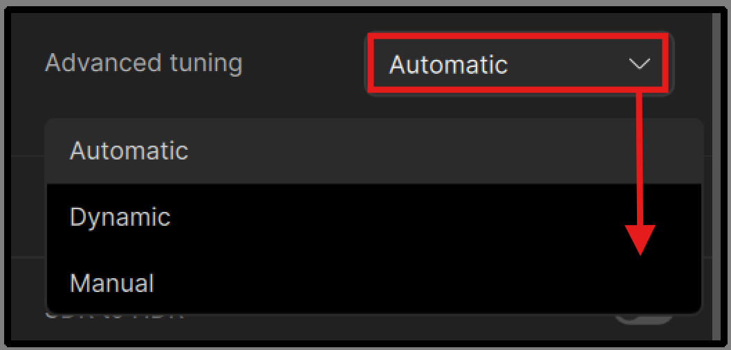

Advance Tuning
Each AI model was designed with certain tasks in mind. That being said, it is worth experimenting with each of the models to see what each option is optimized for. In the Advanced Tuning section, you are able to take full advantage of what the AI Model can do.
Most of Topaz Video's models have the following three modes:
  • Automatic: Determines the optimal settings based on the input video's characteristics.
  • Dynamic (Relative to Auto): This will determine the optimal settings and allows one to add/reduce the strength of each setting based on slider placement.
  • Manual: Gives full control over all settings. Use Estimate to allow the app to generate automatic settings as a starting guide for customization.

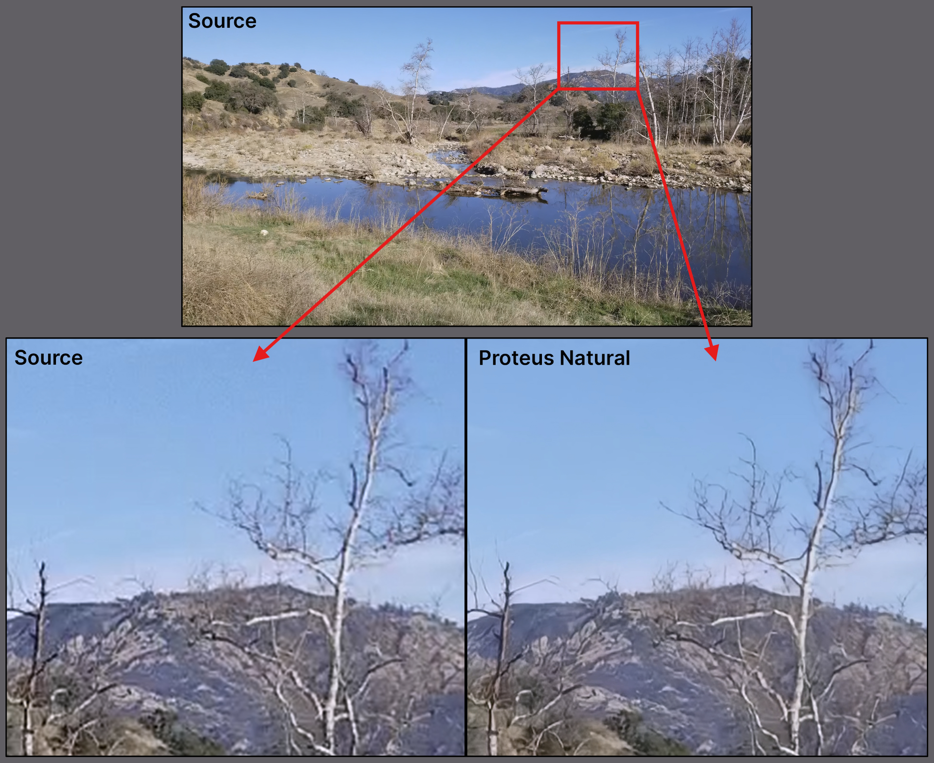

Proteus Natural
Proteus Natural, is the next installment to our popular Proteus ai model. Like Proteus, this is intended as a general up-scaler for most types of content and can render locally and on the cloud.
  • Great for most video conditions and types
  • Addresses compression and general digital artifacts
  • Reduces halos common with older content
  • Respects the original source material -doesn’t overly enhance/modify source inputs
  • Clean upscale that does not distort or warp original source details
  • Addresses aliased edges
  • Great model to mix and match with a second enhancement

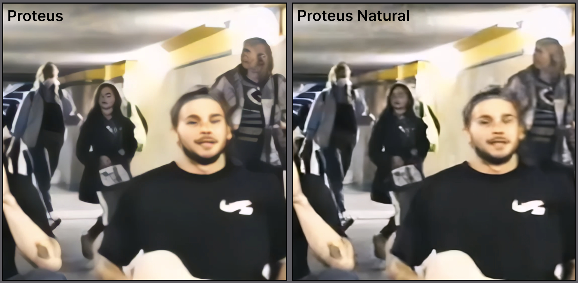

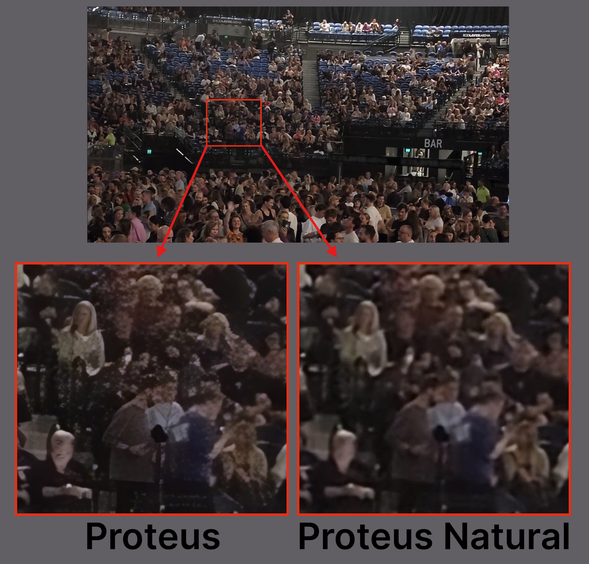

What's the difference between Proteus Natural and Proteus?
  • This model takes the best out of Proteus and improves it with a more natural output that doesn’t over sharpen or “over enhance” everything.
  • Though the original Proteus is quite robust, at times the background texture can appear extra sharp or crunchy. Natural takes this into account and minimizes these types of issues.
  • Additionally, smaller faces (background people -small in scale) can also have distorted faces as a result of Proteus trying to understand a face from pixels of low quality video data. Proteus Natural, reduces this issue and allows for a more subtle touch up rather than an over estimation of the face.

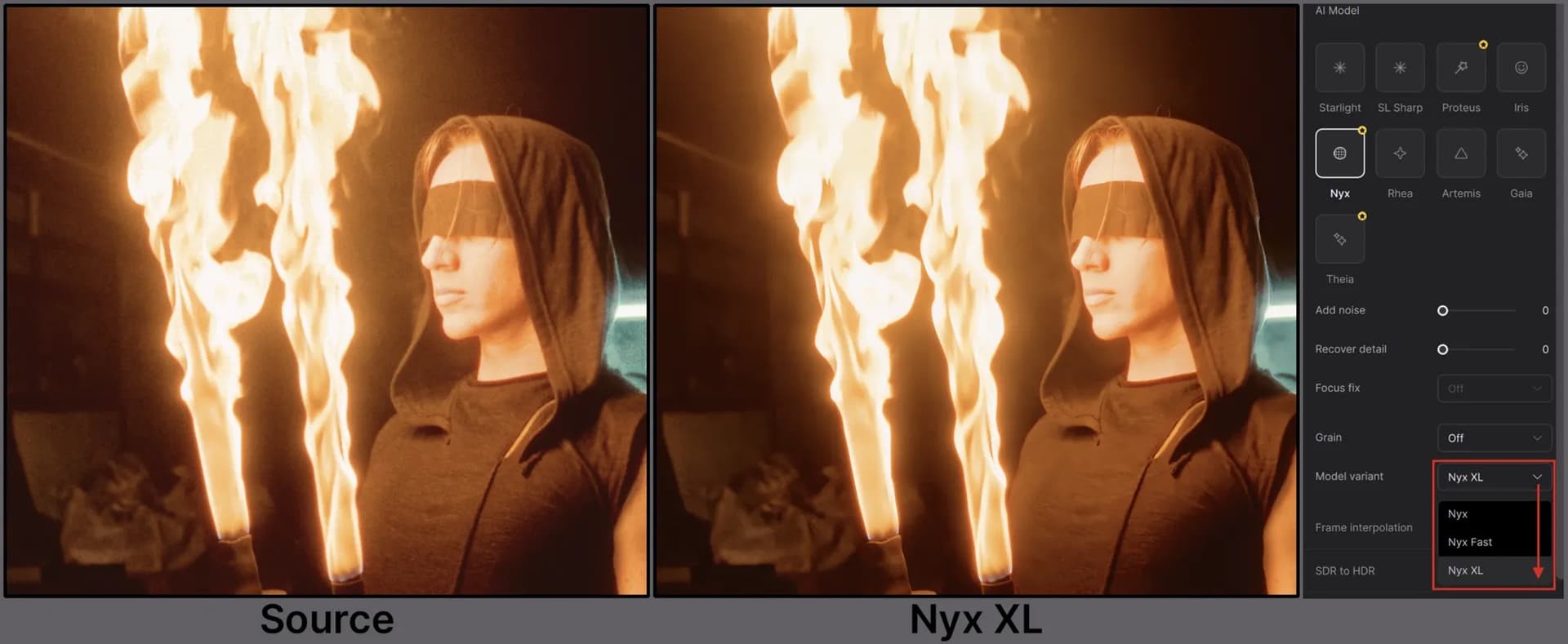

The original Nyx is primarily a denoise model tuned for preserving detail in high-resolution input footage. Nyx XL takes this to the next level by learning the frames and outputting a clean and sharp output.
Nyx XL is optimized for sharpening and denoising a wide variety of footage in many lighting conditions.
This model is geared for high quality and high resolution media.
Nyx XL lends itself as a great chaining model, when merging with a different enhancement. A great results occurred when coupling Proteus with Nyx XL as the second enhancement. What kind of chaining combo can you make with Nyx XL?!
Additional Nyx XL notes
  • This is a more complex and heavier variant of the Nyx Model series. Please note, that this will currently produce slow render times. This is something that we are looking to make more efficient.
  • Please note that previews can take quite a while.
  • It’s not recommended to use with Live Preview due to long processing.
  • This is a one size fits all type of model, so there are no modifiable settings.
  • Though Nyx XL is not limited by a resolution size, this variation of the model is not an up-scaler. Essentially, it will function at the resolution you input and render out the same. Though you can output at a higher resolution, the details and quality will be based on the original input resolution.
  • Please keep the long processing in mind with your machine’s capabilities/resources when calculating larger resolution sizes.
  • Cloud is currently unavailable but will be made available soon!

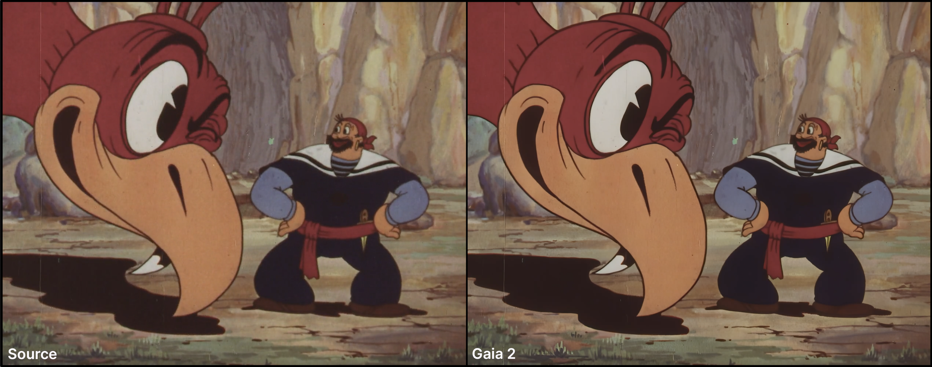

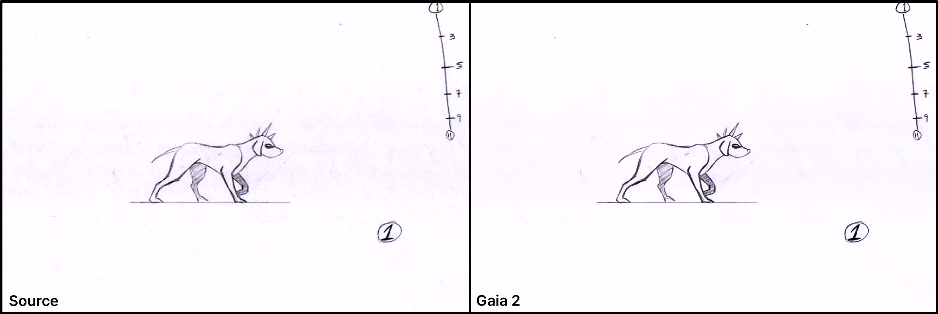

Gaia 2
Gaia 2 works on a frame by frame basis, similar to an image model, which is perfect for traditional types of animation. The unique method is why this model is in it’s own category. Continuing with the Gaia initiative this model has a great handle on animation. This model addresses aliased edges, compression and sharpens without "over doing it". This is not a restoration model, so this will not remove film hairs and scratches or generate details. As a conservative model, it aims to preserve the original source intent. However, if you are looking for a stronger treatment, adding a second enhancement with another Gaia2 will do the trick!
Here are the types of content that this model best performs with:
  • Traditional Animation
  • Motion Graphics
  • Stop Motion Animation
Note that the model is not limited to the content above, so experiment and have fun with this one!

Theia
Theia is great when you need additional detail and sharpening in your footage. Sharpen and enhance details manually to files with 3 parameters for greater control over the final result in either the “Fine Tune Fidelity” or “Fine Tune Detail” modes.
  • Fine Tune Fidelity reduces artifacts and maintains the type of detail it pulls consistently throughout.
  • Fine Tune Detail brings out detail in every frame. However, in doing so, some of these details may slightly differ between frames so this may appear as artifacts at play.
