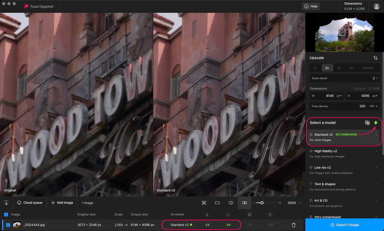

Auto Mode
After analysis, Auto mode suggests a model and settings for enhancing your image. There is a unique Auto mode button for model and settings.
Model
In the Select a model section, click on the lightning bolt icon.
RECOMMENDED will appear next to the suggested model.

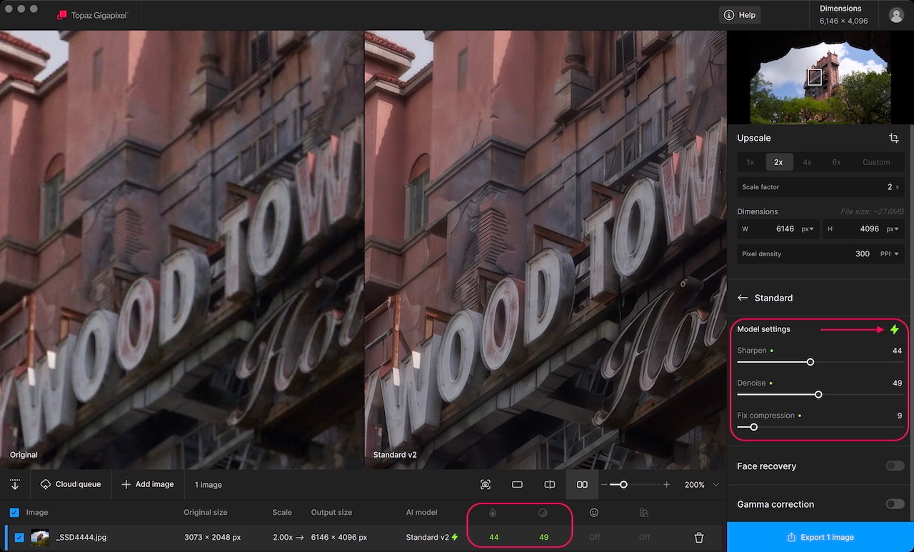

Setting
You can click the model name and select Auto mode for settings to further refine details. The green dots indicate which setting has auto applied.
Turn off Auto mode by clicking on the lightning bolt icon to deactivate it.

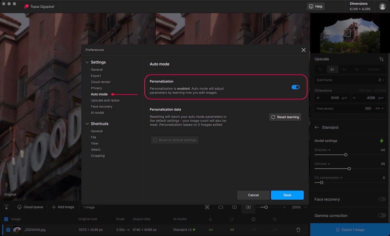

Personalization
There is a preference allowing Auto mode to learn from you, creating a more custom touch when using auto.
Personalization learns from your export history to fine-tune auto settings.
Simply make manual changes to auto-suggested settings; AI will adapt over time based on the difference between what it suggested and the changes you made after.
  • When to use it:
    • You frequently adjust values manually
    • You want tailored AI behavior without editing every setting from scratch
If you prefer not to use personalization, go to Preferences > Settings > Auto Mode, click Reset learning, toggle the switch off, then restart the app.
