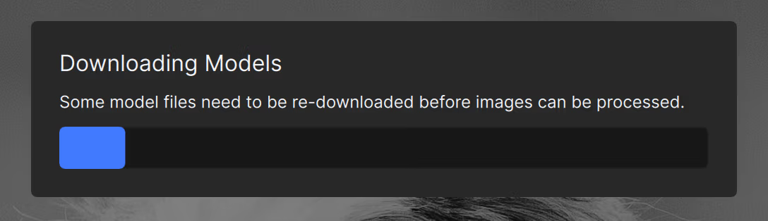

Downloading models
If the app is downloading models each time you open it, it means that they are missing, and the app is trying to repair itself. If downloading models doesn't work from inside the app, please see this page that is explaining how to identify the blockers and install all missing models.

If your Models are installing but seem stuck, no visible progress:
- There could be a blocker preventing the AI Models from installing. Make sure to test turning off the firewall and anti-virus momentarily to see if the install picks up and finishes. Test connecting to a hotspot from your mobile phone as an internet connection to rule out the router being the blocker.
- Once the security features are momentarily turned off or once you are connected to a mobile hotspot, rerun the installer, available from your “My Products" page. There is no need to uninstall; just rerun the installer, and it will pick up where you left off and install only the missing models.
