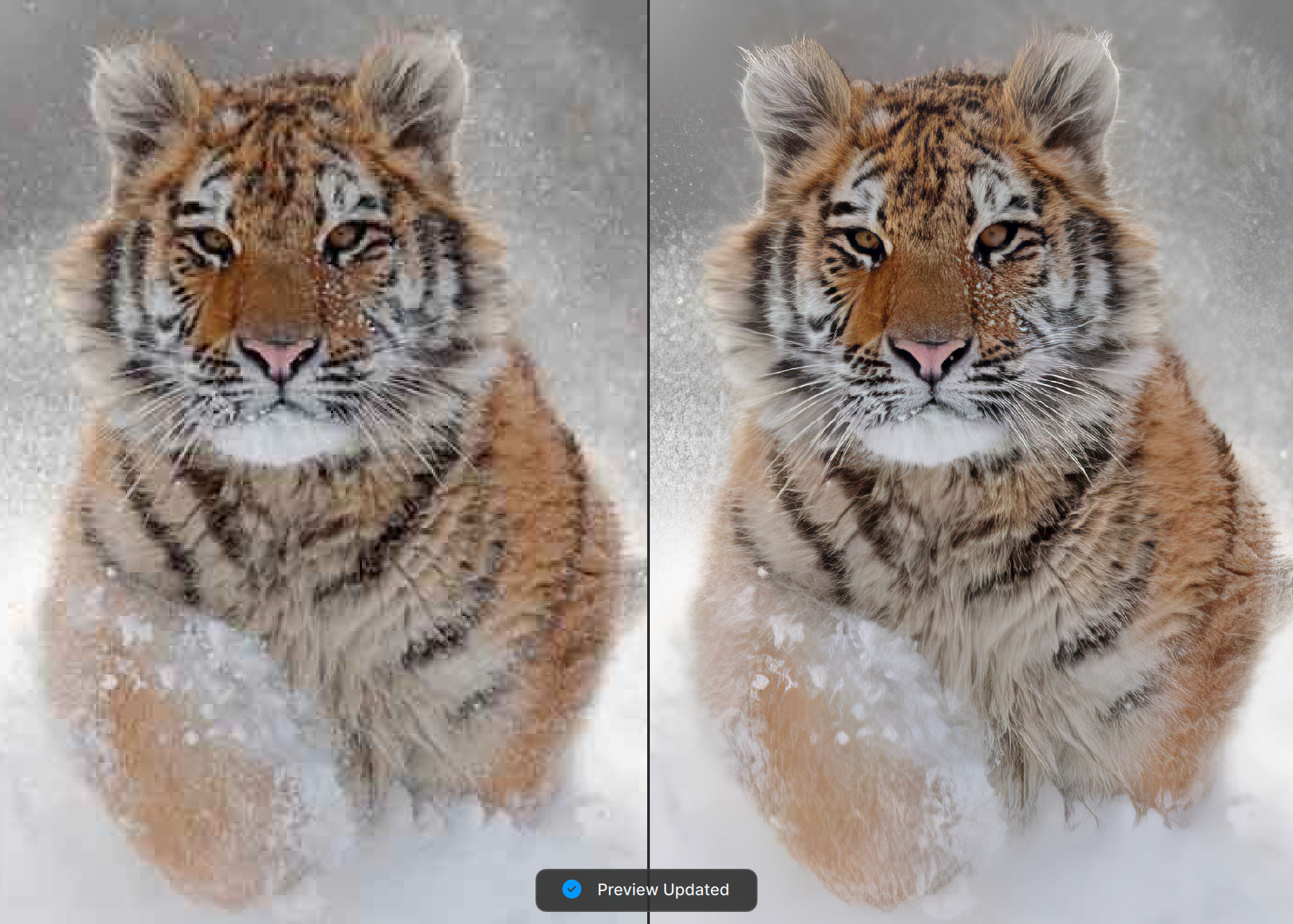

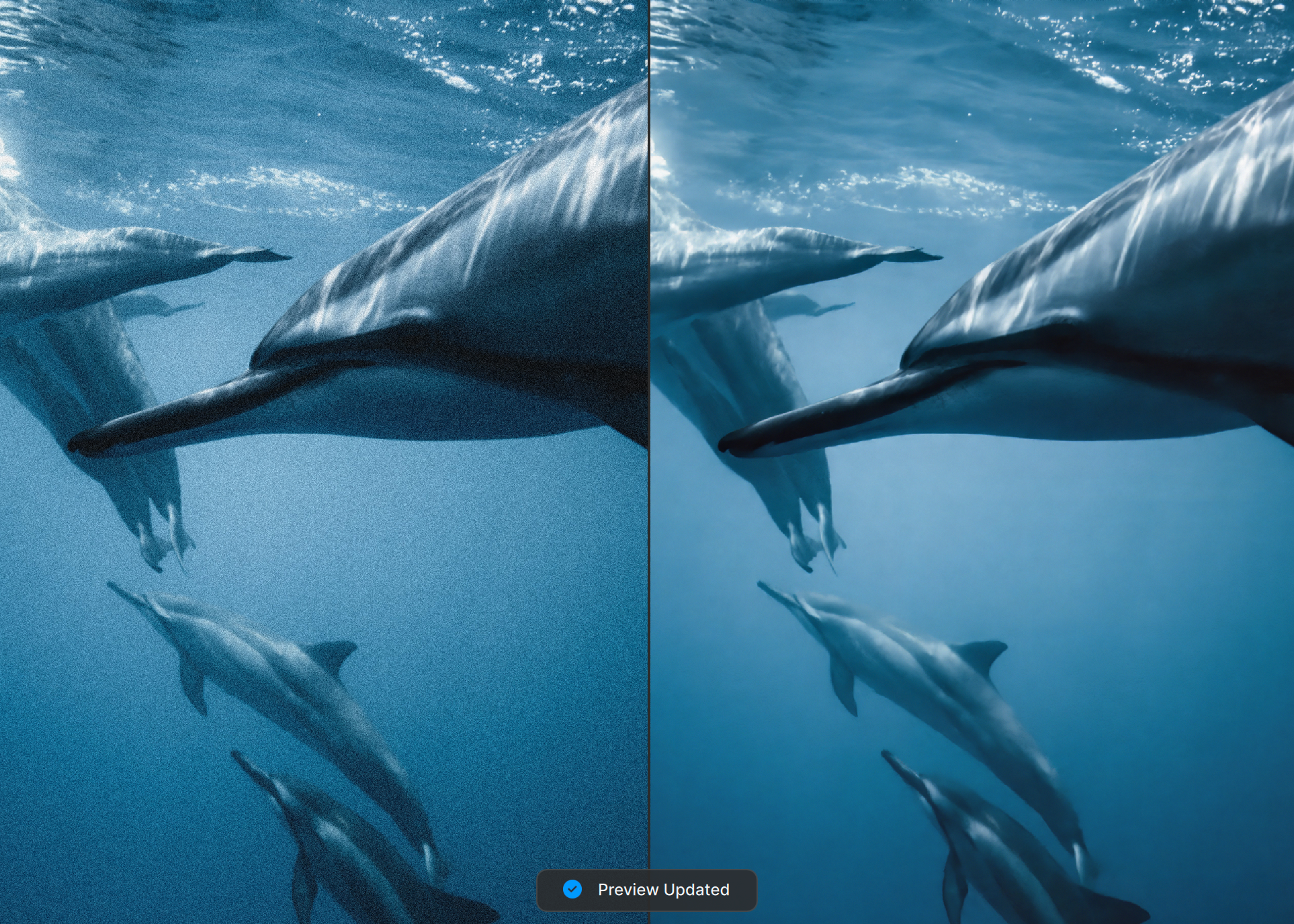

Download the image below, open it in Topaz Photo, and follow along. Sample image
Step 1: Choose Model and Strength
Autopilot selects the Strong model for the sample image because it is a noisy JPG. Choose the Normal model to prioritize detail preservation or the Extreme model to remove more noise.
Even if the correct model was selected, it is still possible that an inappropriate strength setting was chosen. Use the Strength slider to control the extent of your intended adjustments.
The dolphins might look smoother than you want because some fine detail was removed. Decrease the value of the Strength slider. Also, turn up the Recover Original Detail slider.
Step 2: Refine the Selection
To maintain a subtle amount of noise in the background while preserving the dolphins' clarity for depth and dimension, use two instances of the Denoise enhancement.
Step 3: Preview the Final Result
Decide whether you want to make further edits. Once you’re satisfied, you can export the image!

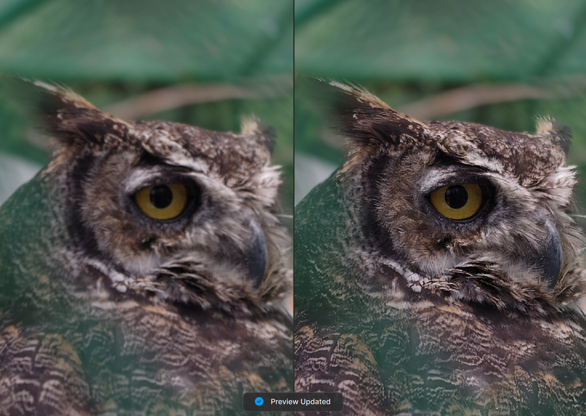

Autopilot selects the Lens Blur model because the image is out of focus. The Standard and Motion Blur models do not sharpen the details as much, and the Strong model can cause an unnatural look.
Even if the correct model was selected, it is still possible that an inappropriate strength setting was chosen. Use the Strength slider to tweak the amount of processing based on your preferences.
There is no noise in the original image so the Minor Denoise slider does not need to be enabled.
Different areas of an image may require different levels of sharpening; in this image, only the owl needs to be sharpened. Select the Subject option in the Auto Mask settings in the Selection tab.
The perception of a "perfectly sharpened" image is subjective. Experiment with the different models and settings until you get your desired result.
Decide whether you want to make further edits. Once you’re satisfied, you can export the image.

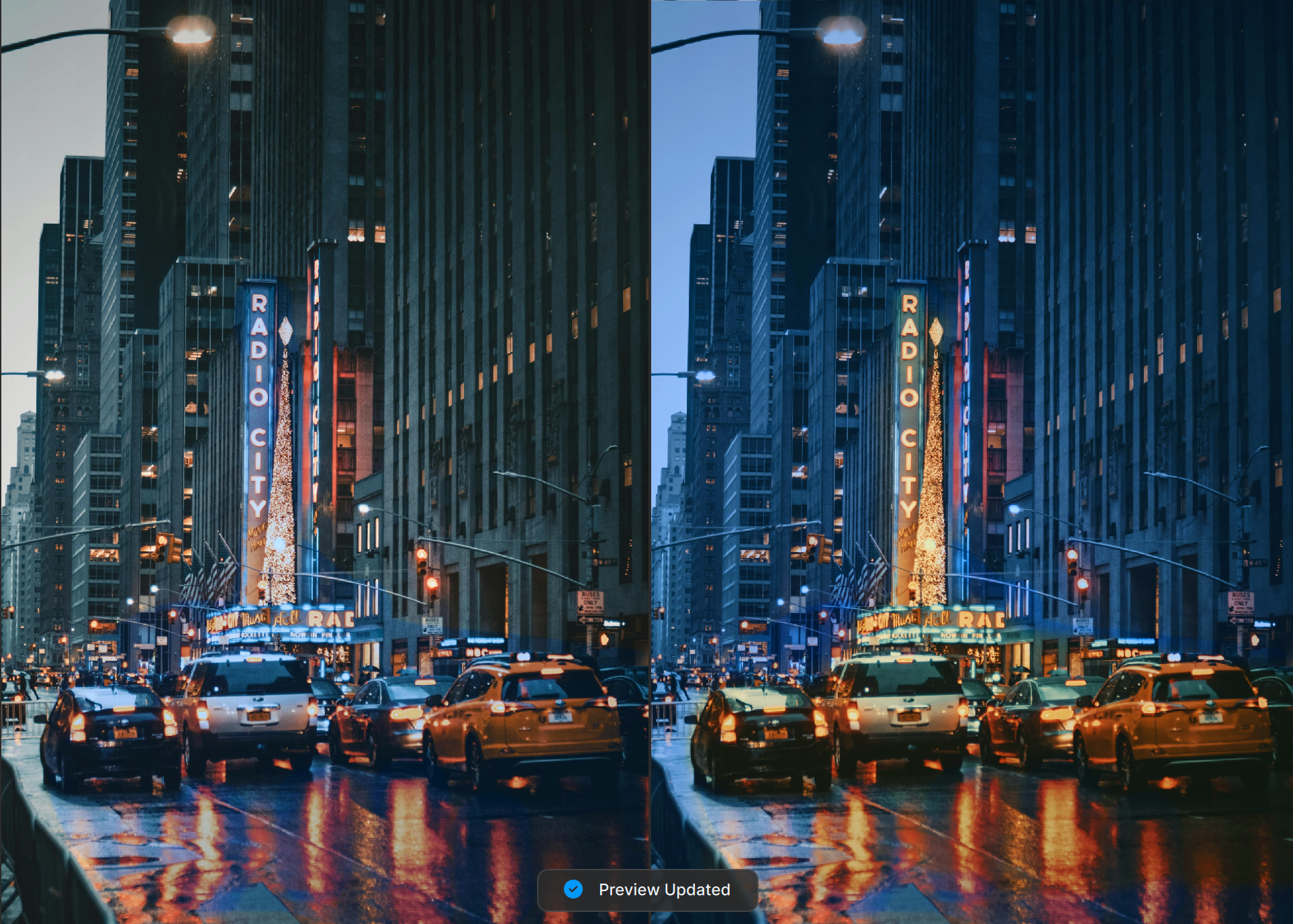

Download the image, open it in Topaz Photo, and follow along. Sample image
Step 1: Determine Direction & Degree
Autopilot does not recommend Balance Color. Add it by clicking the Add Enhancement button and selecting it from the list. The Temperature is 50 and the Opacity is 100 by default.
Use the default adjustments to correct colors by neutralizing color casts for a truer-to-life appearance. This provides the best foundation for creative edits afterward.
Use the Opacity slider to adjust the strength of the color adjustment and the Temperature slider for color grading.
Use different color temperatures between the cars in the foreground and the buildings in the background to create visual contrast and evoke specific moods or atmospheres. In this case, making the entire image warmer does not create the desired effect.

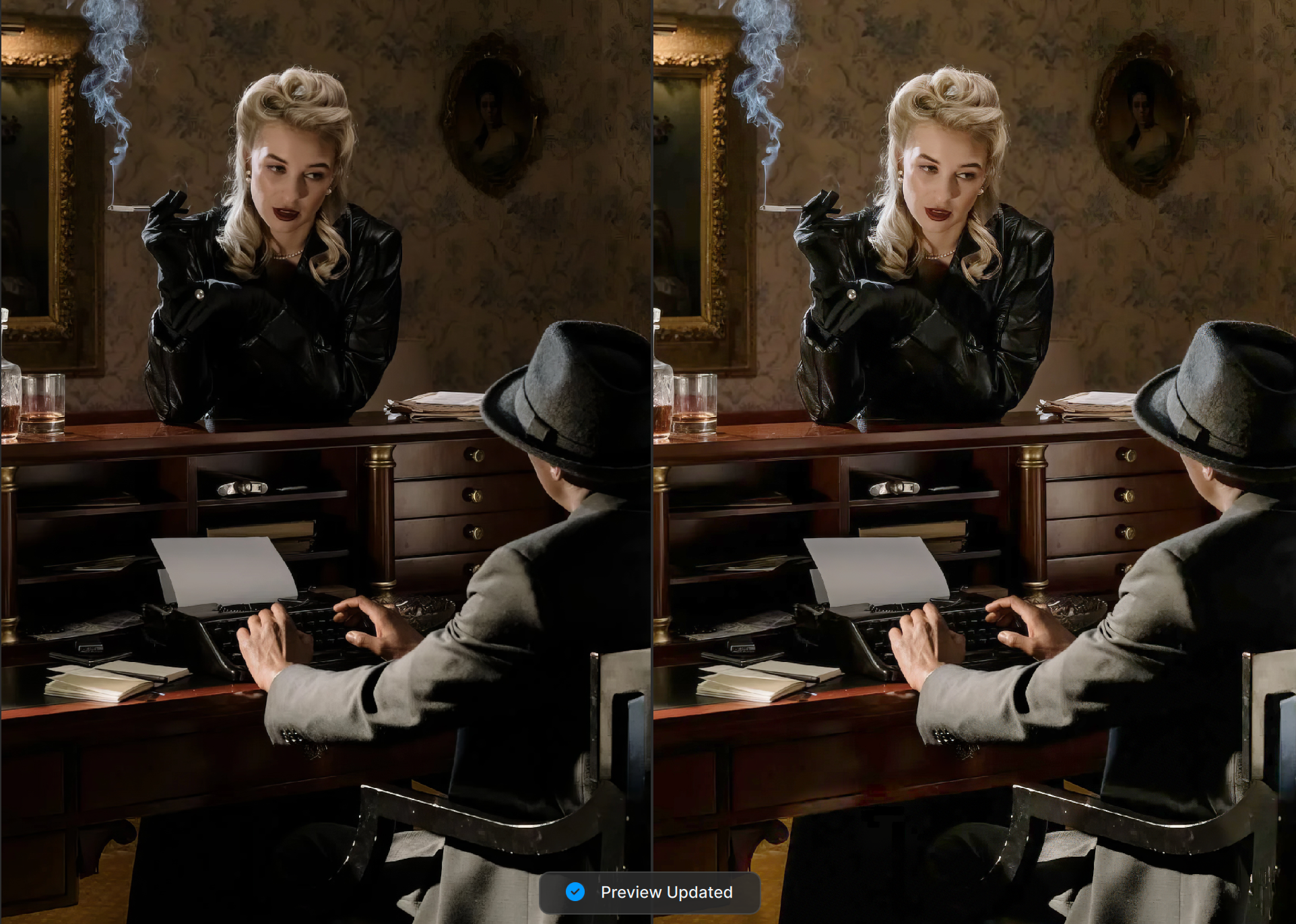

Download the image, open it in Topaz Photo and follow along. Sample image
Autopilot does not recommend Adjust Lighting. Add it by clicking the Add Enhancement button and selecting it from the list. The Strength slider is 25 by default and the range is -25 to 75.
If the image is underexposed, the application will increase the exposure with positive Strength values and decrease the exposure with negative Strength values. The opposite is true for overexposed images.
With lighting especially, the subject and background may require different adjustments and thus different instances of the enhancement.
The Autopilot setting is too bright and undoes the mysterious mood of the original. Adjust the exposure for the people to see the details better yet keep the background dark and moody.

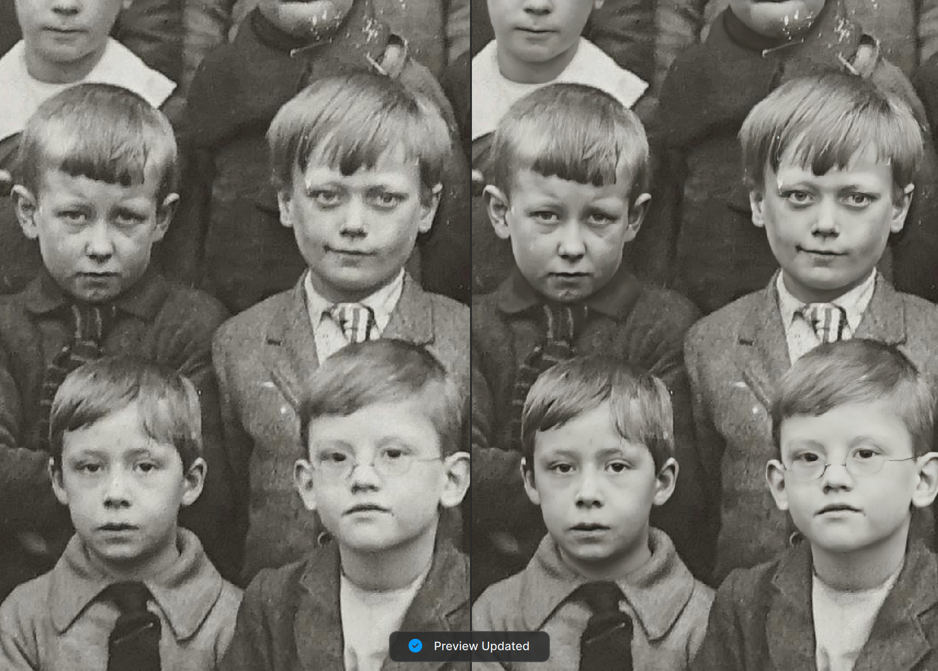

Step 1: Set Strength
The only setting for Face Recovery is the Strength slider. Use it to determine the extent to which the AI-generated face replaces the current one or how processed it appears.
Step 2: Confirm Selection
Navigate to the Selection tab and choose faces for recovery by either clicking directly on them in the Preview or selecting the category within the Selection tab.

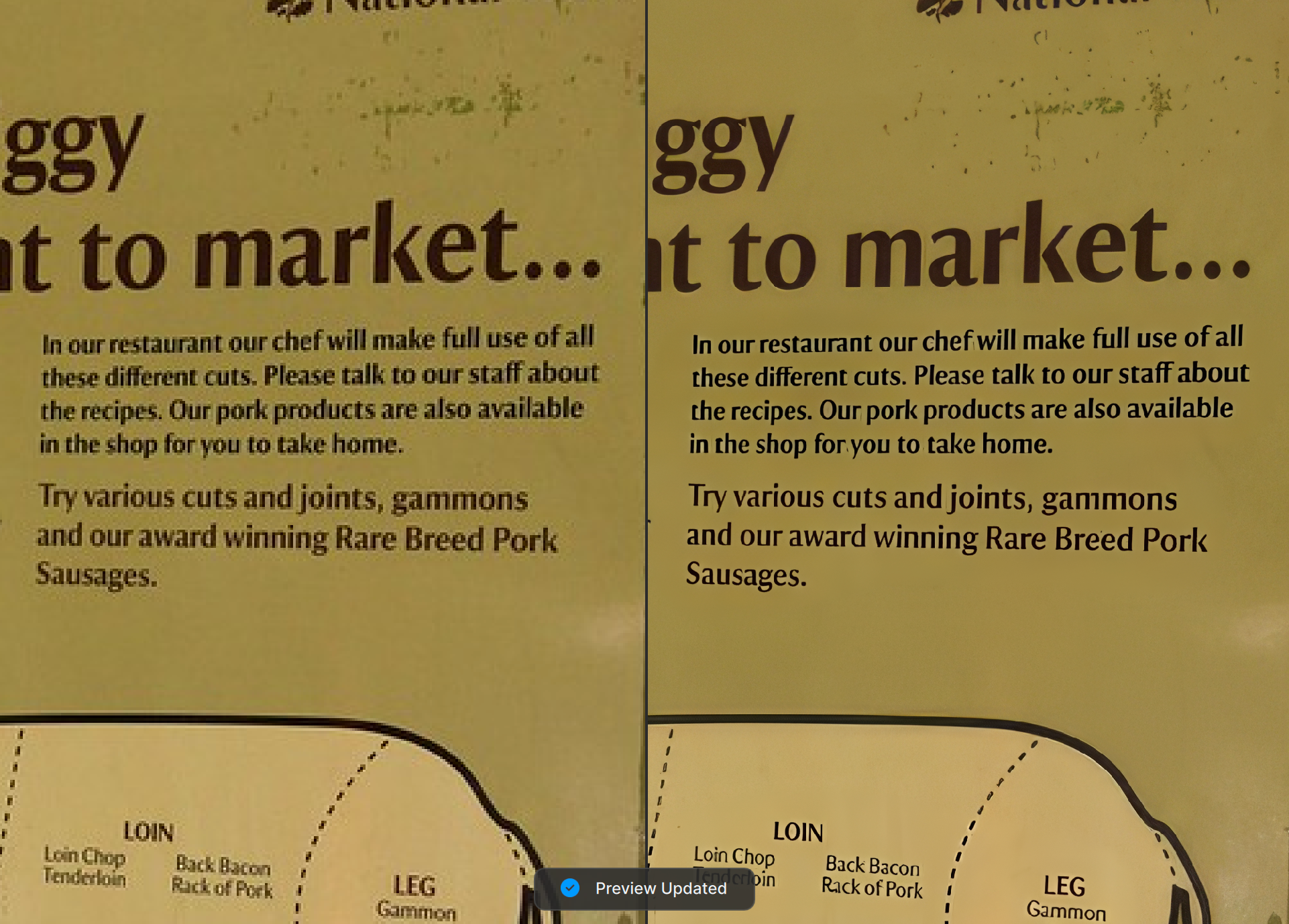

Step 1: Select Text
The Selection tab is the first thing that opens when the Preserve Text filter is enabled. No text is selected by default so you must mask it before adjusting controls.
Brush over the text you want to preserve. Click the Subtract button to unbrush portions of the mask and the Select None button to clear it entirely. Choose Select All for images predominantly consisting of text.
The mask is applied directly to the input image and overwrites the other layered filters.
Step 2: Choose Model and Strength
Autopilot selected the Low Resolution model. Use the Strength slider to fine-tune it to the desired level of preservation.
Selecting the Noisy/Compressed model will distort the text. The models treat different root causes of text deterioration.
