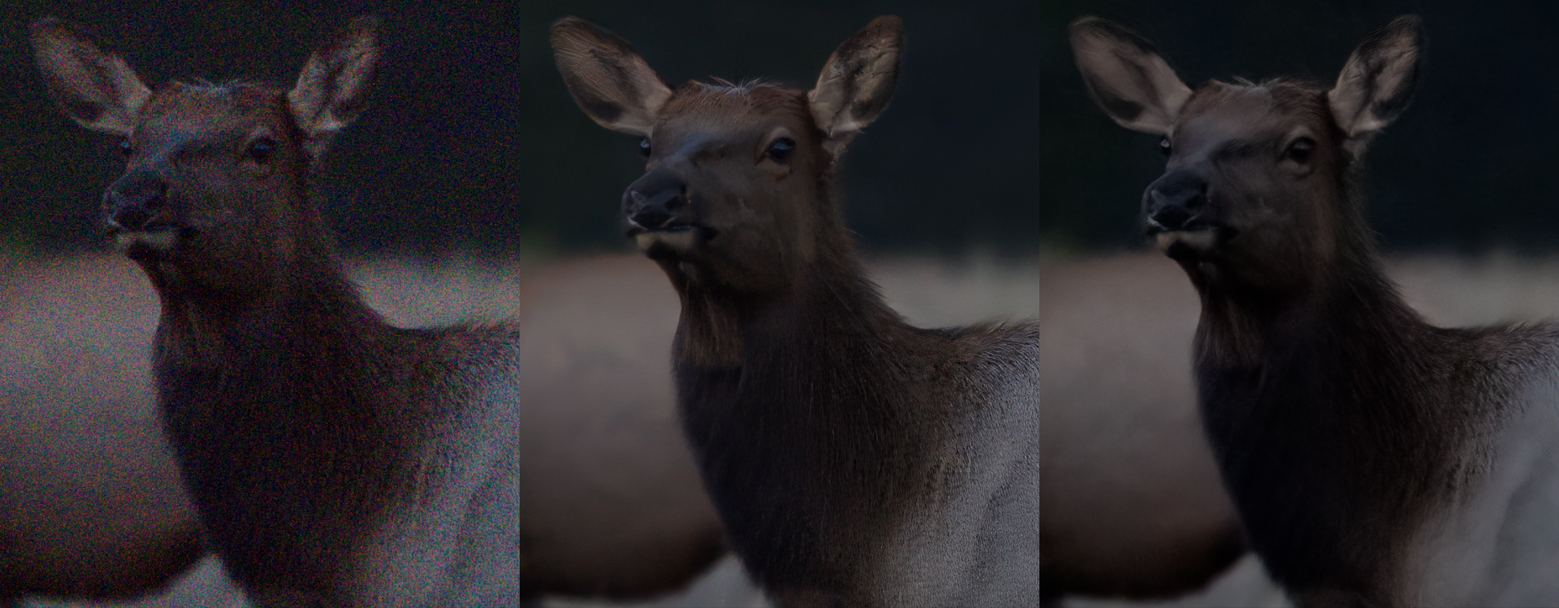

The Raw models are enabled when Topaz Photo AI detects Raw data in the image. They use the Raw sensor data in the file, which contains the most image information and detail.
For non-Raw images such as TIF, JPG, PNG, etc, the non-RAW Remove Noise models are used. The non-Raw models process the pixel data to remove noise.
Raw vs non-Raw Noise Reduction

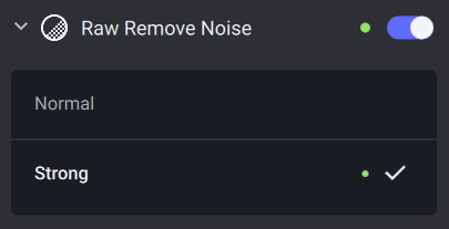

Raw Remove Noise Normal
Enabled when an image with Raw data is detected. Analyzes the sensor color filter array data to detect and remove noise. Best for low-medium noise images.
Raw Remove Noise Strong
Enabled when an image with Raw data is detected. Analyzes the sensor color filter array data to detect and remove noise. Best for medium-high noise images.
Raw Remove Noise

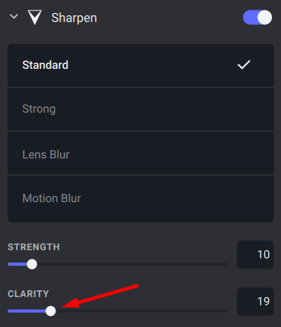

  • Enable the Sharpen filter and increase the Clarity slider

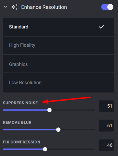

  • Enable Enhance Resolution and increase the Suppress Noise slider
The Sharpen clarity slider performs a mild noise reduction on the subject in the image.
Sharpen Clarity
The Enhance Resolution suppress noise slider performs a minor noise reduction to the entire image.
Enhance Resolution Suppress Noise
